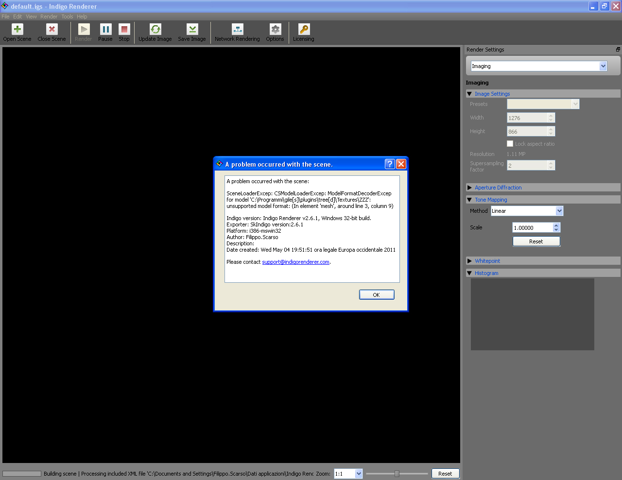

So Dale... I gave this a try and I must report it doesn't work for me. Problems show up after trying the render: the error Indigo gives me doesn't concern specific missing materials, but a general problem loading the mesh. I correctly pre-named the component, activated the instancing method and accurately specified the path to find it (running on XP). Tried different paths but I don't seem to be able to solve anything.

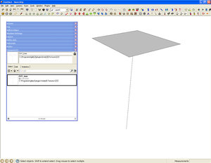

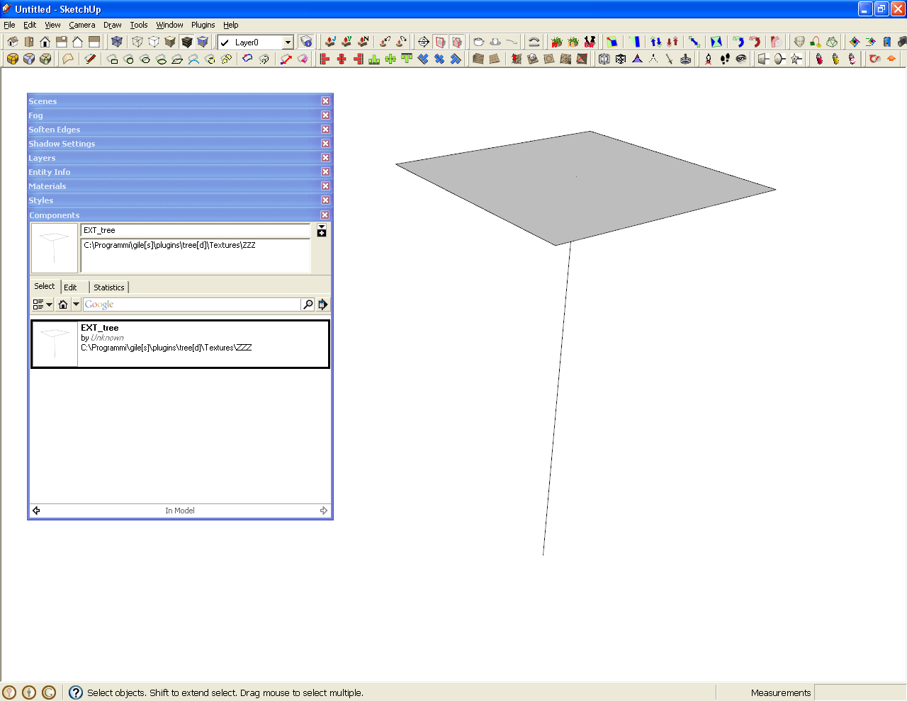

Post by Pibuz » Thu May 05, 2011 6:09 am
Sorry to bother. I made some tests and only few of them (ONE, to be more precise) work as they should. I'm doing tome tests with OBJs created with treeD. Note that importing the objects into SU using the traditional OBJ importer by Fluid (official SU forums) gives no error messages.
I attach two screenshots: one is from SU and the second one is from Indigo. It says something about some line3 column9.. I've followed the instructions by Whaat and the tips I was given by the great Snorky, but nothing seems to work with some models.
I can attach one of them if you want to try..
http://www.box.net/shared/imo14or1ta

Post by snorky » Thu May 05, 2011 10:13 am
ehi Pibuz...
first: wrong path!!! works only with whole path, with file.extension.
second: line " vn NaN NaN NaN " on obj file may cause error

Post by snorky » Fri May 06, 2011 1:44 am
Pibuz wrote:Hi Max! I understand the first error (I don't know why I didn't include the extension....I usually do :oops: )
But I don't manually WRITE the obj, that is just as exported from TreeD!
How can I fix that?
EDIT: fixing the path doesn't solve the problem, same exact issue :?
problem solved!
I fix it with meshlab... is simple and fast.
