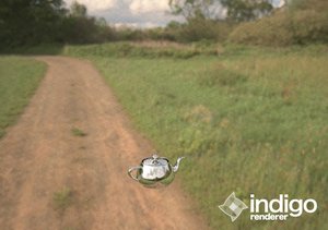

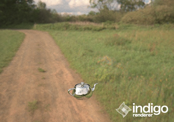

And is there a way to make your scene feel like it is "touching the ground" of the environement map?

Post by galinette » Wed Nov 24, 2010 4:48 am
Thats not really possible with indigo without a little bit of compositing with another software (like photoshop).
In non physical renderers, you can define a ground plane and apply a kind of "shadow matte" material on it. This special material will look transparent but will receive shadows.
In physical renderers you can't. These materials would be violating optic laws and would screw up the algorithms.
Try to render several passes:
- One normal pass like the picture you posted
- One "alpha mask" pass
- One pass with a grey plane for the shadows
Then composite all these to make the required effect with photoshop.
Note that, with your chrome teapot, you will not be able to have shadows on the teapot reflections. Also, if the teapot makes strong caustics, the result may be difficult to composite.
