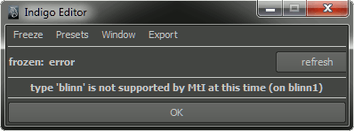

Do not use Maya shaders. I do not think blinn is supported.
Re: MtI 2.x beta 2
Post by CTZn » Tue Dec 14, 2010 11:07 am
what MtI version is this ? I couldn't reproduce it on Maya 2009 and 2011.
As SreckoM said the blinn shader is not supported, this may happen again later. But, SreckoM, I insist that the lambert and phong shaders are optimum with MtI since they provide viewport feedback. With layeredShader and IndigoShader, this makes four nodes in total.

maya 2011, I'll use indigoshader from now on :)
I assigned blinn, and in the palette used the hidden menu thingy to select the material/object and palette closed.

Post by CTZn » Tue Dec 14, 2010 11:43 am
Test 8d ?
Obviously there is something wrong, you should bump into a managed error. Could you see the editor in the following configuration already ? It pops on various events.
managed error configuration

Oh no I don't get that window.
Also I don't have an 'Indigo editor', I have an 'Indigo Palette'.
I have test 8d..
Is there a way to flush mti and start from scratch? I still have ganky old icons too so I guess it might not be installed correctly..
Maya 2011 Winxp 64
Re: MtI 2.x beta 2
Post by CTZn » Tue Dec 14, 2010 6:06 pm
I have not been carefull enough while changing files name, you probably ended with too many mel files in the scripts folder.
Can you please compare the archive's script folder content with your local user/documents/Maya/scripts folder ? Just delete any mti_*.mel that is not in the archive and restart Maya.
It is also possible that the start on install thingy is not strong enough. I tend to believe that it is safer to reboot Maya after installing MtI.
Sorry about the mismatch, I'll look into this.

I just renamed my documents/maya folder and reinstalled Mti. Now I have the Indigo Editor and it works as it should :)
