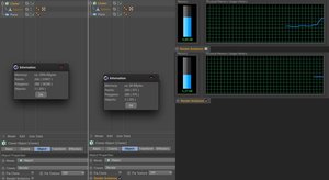

I surely wrote something wrong, because I am not sure what are you trying to say. Look at these screenshots:
When I wrote project size, that is exactly what I meant, project size, not the file size of the project on our hard drives. It's RAM usage obviously increases when we switch off our "render instances" option, and if I try to export to Indigo a forest scene, or a lawn, with huge number of instances the usage of RAM from the C4D hinders that.
Now, please correct me if I am wrong, but could it be that you are trying to say that no matter what the choice is, using or not using the "render instance" option, the total usage of our RAM memory remains the same if we choose to render our scene "externally", from the Indigo itself? For example: We are using "render instances" option, we have less usage of our RAM memory from the C4D itself, but when exported, the usage of our RAM memory increases to value A. But, if we choose not to use "render instances" option, our RAM memory from the C4D itself is greater, but when exported it doesn't increase, and is the same as the value A, or similar? I don't think that you wanted to say that, tbh, but I have to check it, just to be sure.
Or is it possible that you wanted to say that the RAM usage from the Indigo itself is the same, no matter the option we select ("render instances"off/on)? Because, I think that is true. But, I still want C4D to use as little as possible RAM memory, and with suggested solution, I think we can pull that trick out. :D
Because, you see, this is not about a problem of RAM usage from the Indigo, but from the C4D. And if we say to our exporter, with our instance tag: this object, export it using this algorithm, then it could be possible for C4D to use much less RAM memory (because of the "render instances" option on), and for us to utilize all kinds of different possibilities (for example, different types/textures/bumps/materials on our instances) without using complex ISL codes. Indigo RAM usage will remain the same in both of the cases, but C4D will use far less RAM with "render intaces" on, so in the overall, we would use less of our RAM resources.
