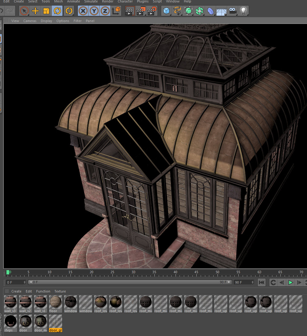

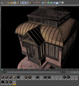

I've imported a textured object into C4D. When I render with the Standard Renderer, I get this image:

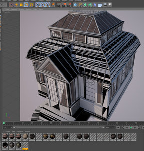

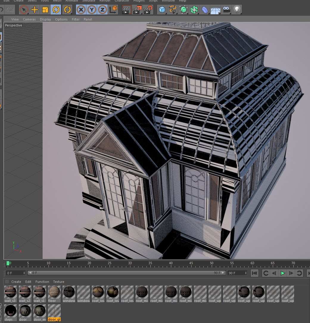

When I render with Indigo Renderer, I get this image:
The wonky render occurs whether or not I convert the materials. If I choose to convert, either inside of C4D or via the Indigo Exporter on export to an .igs project file, the wonky render appears both in C4D and in the Indigo stand-alone UI.
I get the same results whether I import the object in its native format via InterPoser Pro, or if I create an OBJ and import via Riptide Pro.
I get the same result no matter what Render Mode I set. Interestingly, I get what seems to be an accurate render if I enable GPU acceleration. But if I switch back to software rendering, the wonky render returns.
In the Indigo stand-alone UI, the OpenGL preview is accurate. It's only the Indigo render that has problems.
There is a single Infinite Light in the scene, and it is set as the Sun in the Indigo Renderer Settings.

The last selection on the object is a selection of all polygons. That one is causing the problem. For now you can fix it by deleting that last selection tag.

Each of the model's groups has a group tag and then the last selection tag selects the group. I tried deleting the selection tags, but then Indigo apparently couldn't see the groups and they rendered black. It was if, for each tag, I clicked "Hide Polygons", and then tried to render with the polygons hidden.
So then I deleted the group tags as well, with the same results: the polygons without an alpha channel, i.e., everything but the windows, rendered black. The windows rendered as some sort of creamy white opaque color.
Undoing all that restored the original wonky render.
EDIT: I thought the black render might have something to do with Normals pointing the wrong way, but when I imported the object's Normals along with the object, it just made things worse. Almost all of the model rendered black. I didn't spend any time trying to find a pattern in what parts were visible and what ones weren't, because the visible ones rendered as a solid yellow color.
