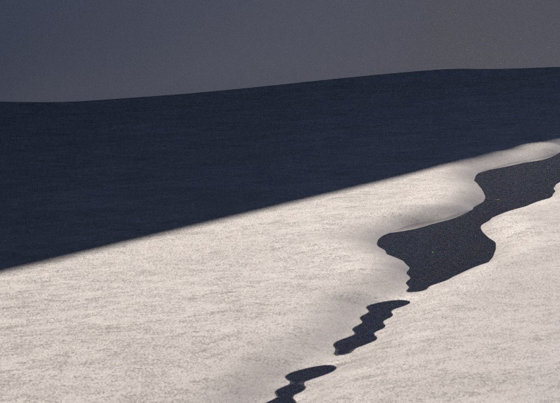

I've tried a lot of different settings now, but it seems I get black water no matter what I try so I must be doing something fundamentally wrong. I'm rendering with BiDir MLT. I've tried almost every water material in the database, turning on/off SSS although I'm not sure what it does. This is the material I'm currently trying: http://www.indigorenderer.com/materials/materials/31. I've tried exporting the scene in mm, cm, m, km, user:25, user:0.025 and user:0.0025, (in c4d the Project Scale is set to 0.025 m). I've tried setting the texture length U/V from 0.001% to 10000%. I've tried cubes from 0,01 m thickness to 10 m thickness.
Before I waste any more time, I thought I should ask and see if there's a simple solution.
Does the amount of faces/subdivision of the water cube factor in at all?
Does the water become more transparent the more samples per pixel? I've only tried around 500 spp.
I'm using the most updated Indigo 4 with C4D R17. Thanks.

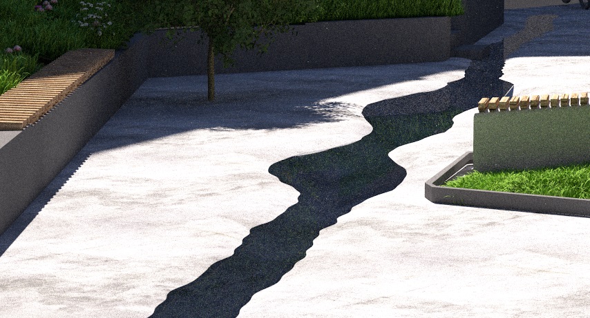

Hmm... I tried making a new scene with both Project Scale and Indigo export scale set to cm. There's only a ground, water, light and camera in the scene, but the water is still not transparent at all. Could someone have a look at this specific scene? Nevermind the two holes in the ground plane.

This particular material is very expensive to render, especially with SSS. Everything is fine, it just takes more time to render it. You can see even in your screenshot that the caustics are beginning to form on the ground (those green dots). Try using a normal specular materials without any sss, just the absorption.
