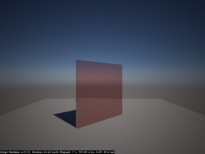

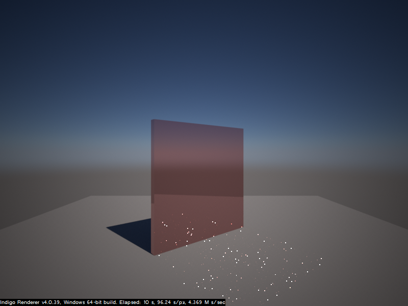

OnoSendai wrote:* Added preliminary support for contribution clamping, including UI support. Works on CPU and GPU. Added controls to mode configuration area in render settings.
Could you please explain it further?
Re: Indigo Renderer 4.0.38 Beta Release
Post by OnoSendai » Sat Jun 18, 2016 1:29 am
Contribution clamping basically works as a firefly filter.
If it is enabled, and the max contribution is low, then it won't allow bright spots (fireflies) onto the render.
As the max contribution gets higher and higher, brighter and brighter spots are allowed.
So a max contribution of infinity corresponds to contribution clamping being disabled.
Since it is clamping bright spots, it does introduce bias into the render. Because of this it will be off by default. (We want Indigo to be unbiased by default).
However it should be a very useful tool for artists, to remove fireflies from their images in a simple and efficient way.
An example:

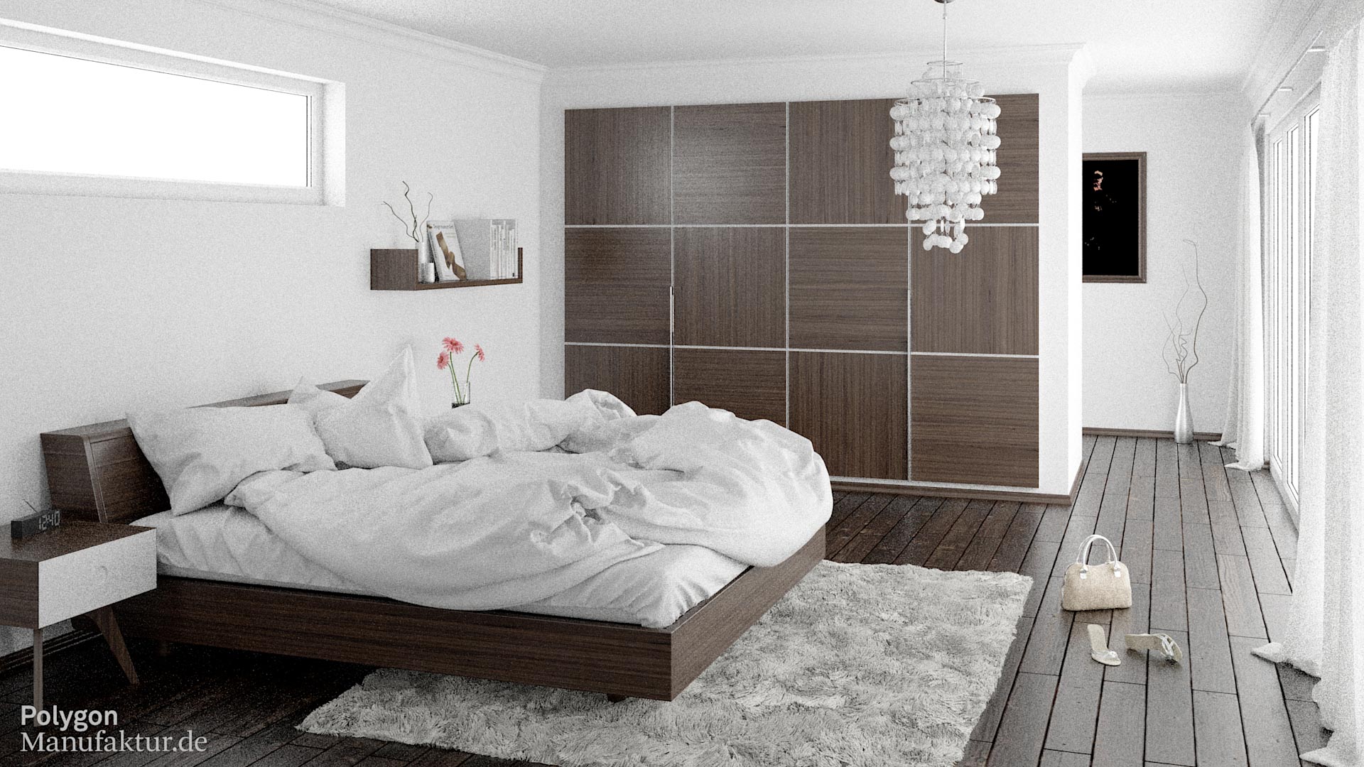

Post by Originalplan® » Sat Jun 18, 2016 4:12 am
Much improved from the first Beta build!!
CPU Rendering seems faster (LOT) then before.
GPU render (correct me if i'm wrong) feel and behaves MUCH smoother! Specially on startup!
Feels like data stream is much more optimized and more efficient then before.
AND Indigo (App itself) is remaining pretty responsive during GPU rendering, which is a huge plus!
-Clamp contributions : LIKE A DREAM!
And the many more improvements i didn't even get too.
All in all very solid build!!
@Ono my two FirePro's are sending you and the Glare team hugs and kisses they feel much cooler now. :D
Check out the test scenes and render times below from Oscar and Arthur.
3min= 1.914M/sec
3min = 6.527M/sec

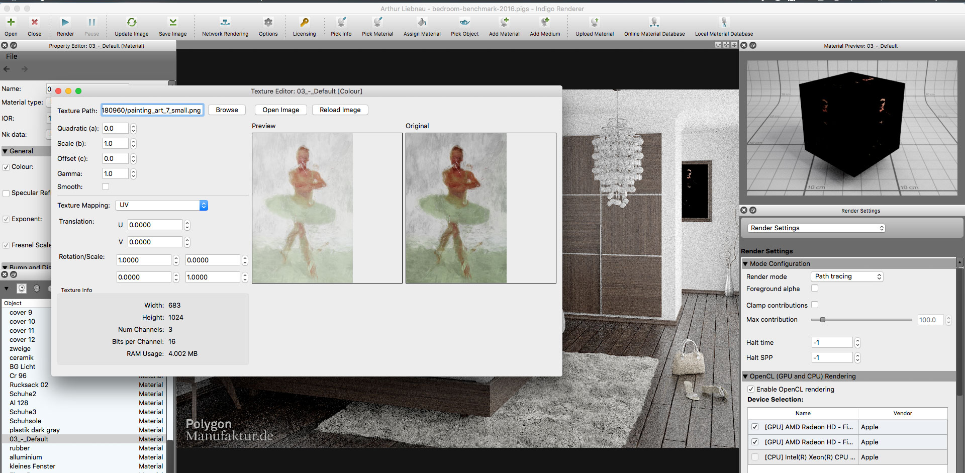

Post by Zom-B » Sat Jun 18, 2016 4:19 am
the painting in the back is... ehm... black O_o
Is this issue repeatable?
yonosoy
Posts: 3439
Post by yonosoy » Sat Jun 18, 2016 4:24 am
Same issue with your scene on v4.0.37 two days ago. And actually with v4.0.38. For cpu is right.
Originalplan®
Posts: 757
Post by Originalplan® » Sat Jun 18, 2016 4:28 am
Zom-B wrote:the painting in the back is... ehm... black O_o
Give me a sec to re render and check it. Mr Zom-B ^ . ^
Originalplan®
Posts: 757
Post by Originalplan® » Sat Jun 18, 2016 4:39 am
Unfortunately it remains black, but texture seems OK.
I had this issue only with cutout materials on GPU (but that was because GPU didn't rendered alpha in 4.37.
The problem is not with your scene i think it's because you used a .png and maybe the surronding area in the pic is too bright (white) and it recognizes it as an alpha.? Not sure.
Post by OnoSendai » Sat Jun 18, 2016 4:40 am
Yeah the black image is a bug to be fixed.
