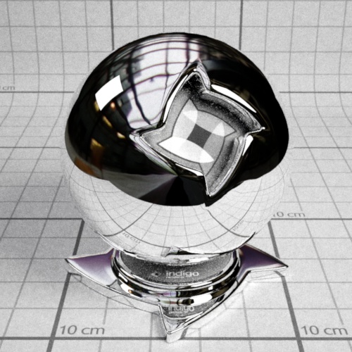

contegufo wrote:What are these flares?
Bokeh like Zom-B mentioned.
grass bokeh

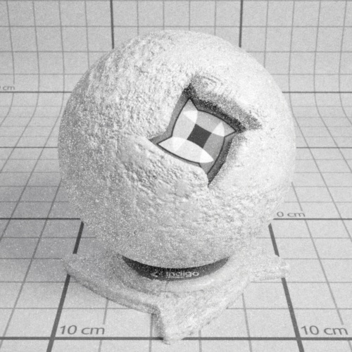

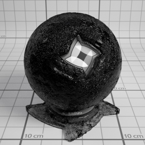

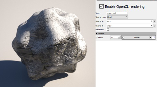

It seems that I have this problem of defining what is a bug, and what is not, since I got no clue how the things should work "normally" in the GPU mode. Notice how those bumps in GPU mode are a slightly "heavier" then those on CPU, and the only difference made was those subdivision levels. I guess it all has something to do with how the GPU mode access the normals of the object, or something. Adjusting the intensity in the code, or for the texture - parameter b will fix this, but it kinda gives this uneasy feeling (is it right, what is the truth, etc. xD ). But, in the end, it's all about results! :D

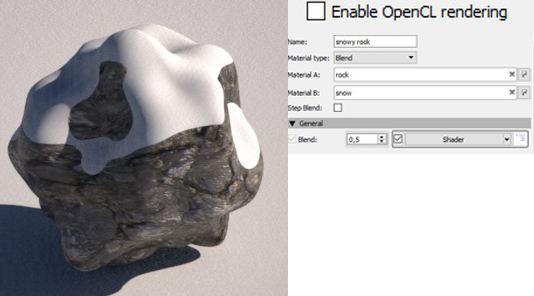

As for the snow mixture material, Snowy Rock, I found out this weird thing. If you enable the GPU mode, then uncheck the shader controlling the blend, and type 0, sometimes you get this pointy ball from hell.
Also, the shader will work normally, if your geometry's deformation is actually pre-baked. Guessing it has problems accessing normals of displaced geometry, something which is avoided if the mesh is imported as pre-baked. In this case, GPU also has "heavier" bumps, but it is more noticeable then with ISL.

Post by Zom-B » Thu Jun 30, 2016 11:59 pm
hey guys, I just doublechecked the buggy Materials with show (ISL in Blend causing GPU to render strange stuff)
and the other ones with some ISL on Bump channel that caused artefacts on the GPU.
Both Issues are now in the Bugtracker, and I am sure the devs will take care of it, again big thanks for reporting!
About your "video driver stopped" issue Zalevskiy:
All the materials render fine on my AMD card, since the mats have some quite heavy subdiv on them this may cause your quite old low RAM GPU refuse to work.
Anybody here with a newer NVIDIA card and up 2 date drivers can doublecheck these mats:
http://www.indigorenderer.com/forum/vie ... 28#p136428
This here rendered on my GPU but looks different because of some missing stuff like tabulated data on GPU:
http://www.indigorenderer.com/forum/vie ... 29#p136429

@Originalplan®, @Zom-B
These optical aberrations are due to the implementation of the physical photographic camera, if you do not disturb can be like.

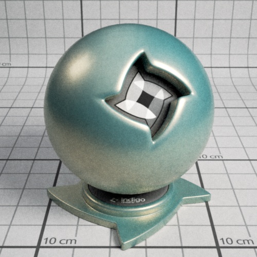

How realise Car Window Tint 5% | 20% | 35% | 50% with GPU? You could not place an alternative way to play the darkened glass?
Please download the material if it is technically possible with the GPU, thanks :)
Re: Indigo Renderer 4.0.39 Beta Release
Post by Oscar J » Fri Jul 01, 2016 5:10 am
Glass absorption should work fine. Just go to the material medium and enable it.
Post by pixie » Fri Jul 01, 2016 7:37 pm
Indigo Renderer 4.0.38/39 Beta Release
Material: Double-Sided Thin
You got your lens smudged... :p

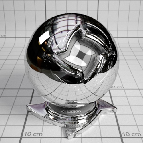

Chrome_Logo.pigm
