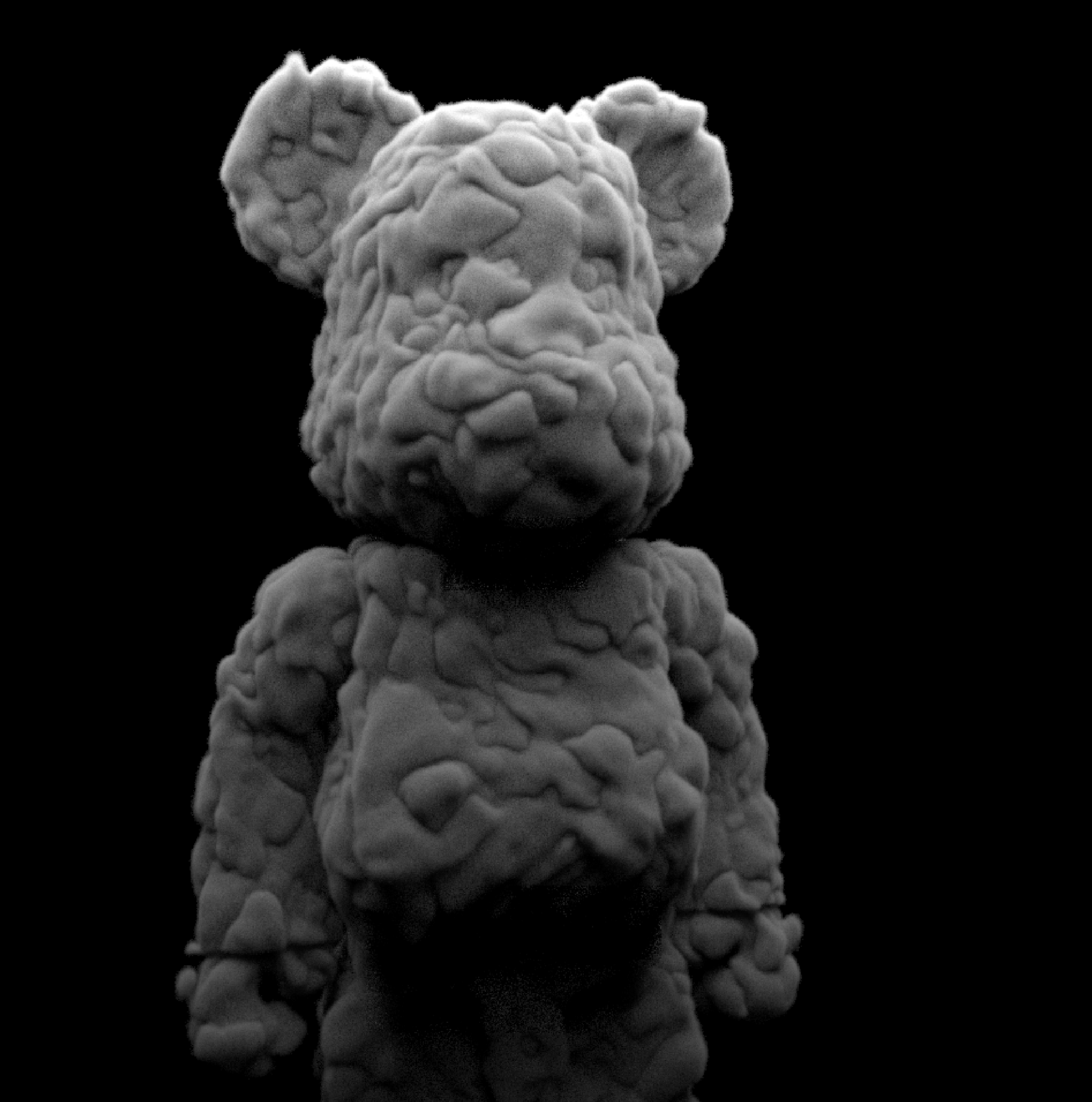

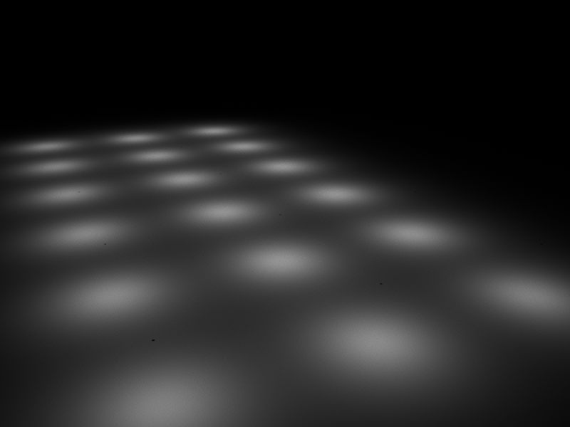

We have made some optimisations on the CPU rendering side, but the biggest improvements are to do with smarter sampling of emitters.
Here is an example of the improvements to CPU single-directional path tracing: (this is about 13 samples per pixel or less than 1 second rendering time)
Indigo 4.0:
Indigo 4.2:
As you can see there is a large reduction in noise in Indigo 4.2.

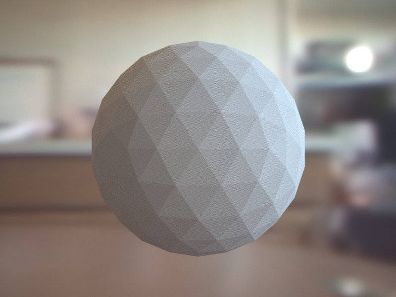

We have improved env map sampling as well:
(40 samples/pixel, single dir)
Indigo 4.0:
Indigo 4.2:
This improvement is a bit more subtle, but if you look closely you will see the noise is reduced in the Indigo 4.2 render.

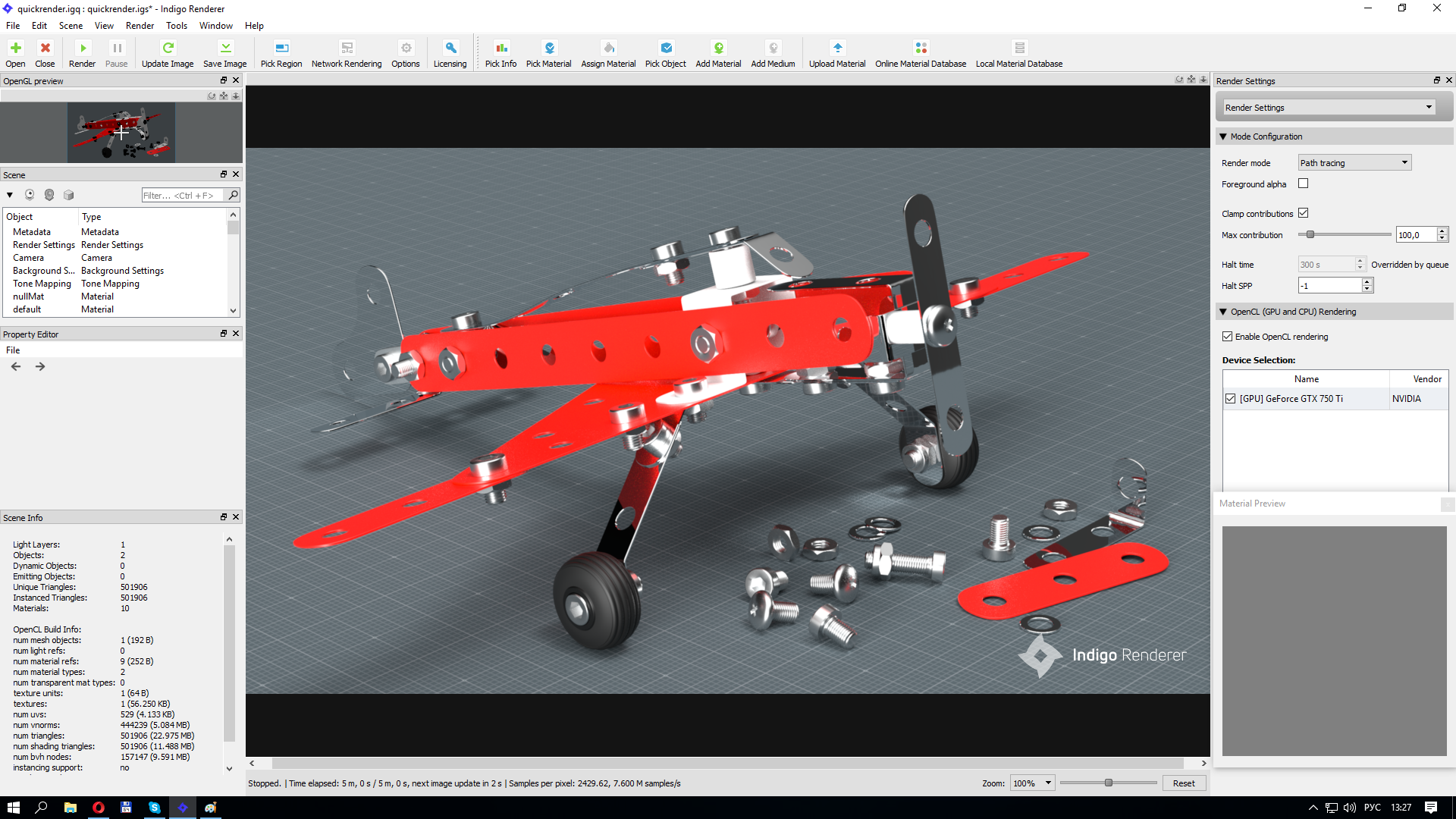

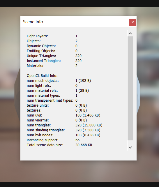

We have also added a new scene info widget which has scene and build information:

* Added 'Scene Info' widget. (available under Window menu) Shows scene build statistics, with extra details for GPU rendering.
