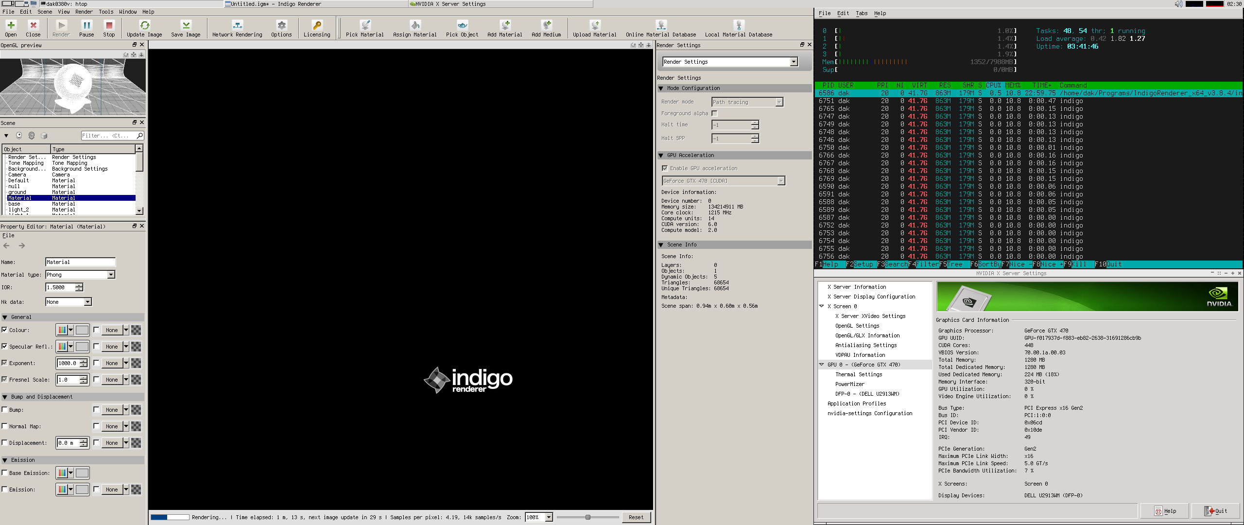

I wasn't successful to render anything with CUDA under ArchLinux:
dak@380v ~ % uname -a
Linux 380v 3.15.1-1-ARCH #1 SMP PREEMPT Tue Jun 17 09:32:20 CEST 2014 x86_64 GNU/Linux
With OpenCL everything seems to work as intended:
With CUDA rendering seems to start, but then halts and the only way to exit Indigo is to terminate the process:
Here is the report from hwinfo:
dak@380v ~ % hwinfo --gfx
