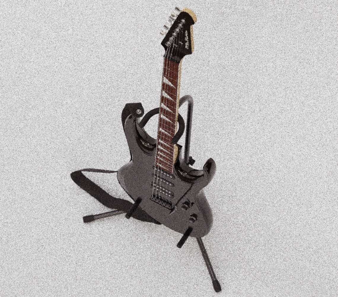

Shorter renders will have a grainy appearance, much like using a high ISO setting and fast shutter time in a real camera. This grain decreases with time: The amount of noise is initially quite high, but very sharply decreases. Eventually a plateau is reached where the image quality is not noticeably improved with further rendering, and rendering can be stopped.
| 1 second | 30 seconds (Scene by Arthur Liebnau) |
In general, most people will just leave their scene rendering until it looks clear enough for their purposes. As time goes on, the image will become clearer and clearer.
