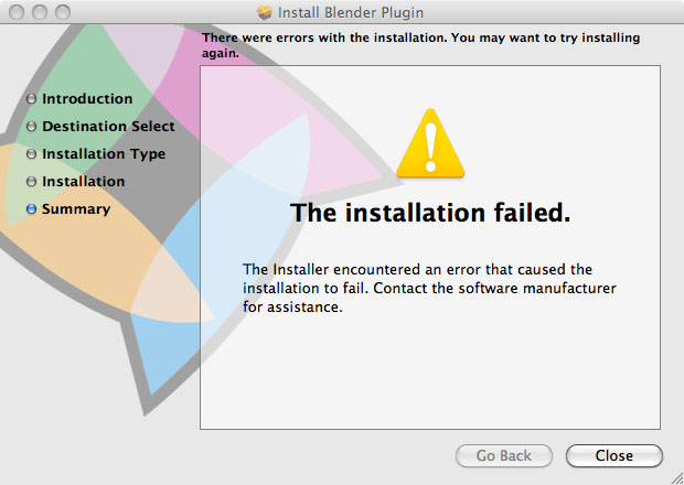

I'm guessing you are making assumptions about paths ben? I haven't had a blendigo installation fail on mac prior to this release. With release of Snow Leopard I decided to do some restructuring of my system layout and I no longer install blender directly in the applications folder. Can't think of anything else that would cause this to fail.
