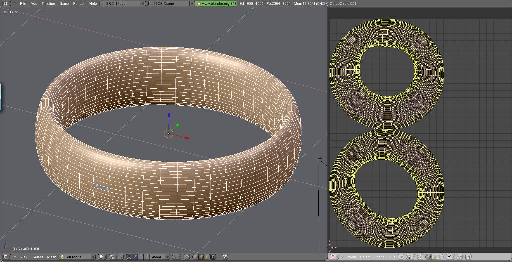

Did I mention that I hate UV unwrapping?
This gold ring is effectively a deformed torus right? Unwrapping it should be simply a matter of marking two edge loops as seams. One around the circumference of the ring and another around the circumference of the cross section.
Easy yeah? Nope. Blender refuses to unwrap that into a rectangular texture. It tries everything possible to distort/screw/wreck/bollocks the humanly obvious natural rectangular topology that should result.
At the moment it's looking like I am going to have to manually calculate positions for all vertices on the seams (approx. 900) and pin them around the outside of the texture. Even then I suspect that blender is going to deform the internal vertices into some wavy-ass shape :mad:

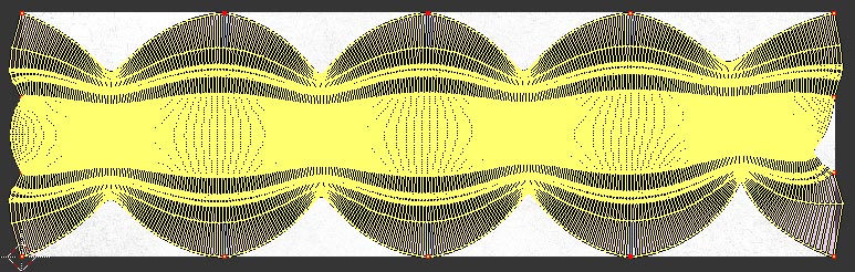

Post by WytRaven » Wed Jul 08, 2009 1:57 am
Feel my pain :(

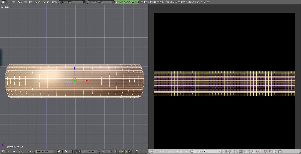

And what is so wrong about this one? Distortion can be removed quite easily via proportional editing!
Polinalkrimizei
Posts: 649
Re: The Renderer's Rings
Post by Polinalkrimizei » Wed Jul 08, 2009 3:59 am
wait... this looks a lot more rectangular to me. It is "cylinder from view" from the uv-menue, you'll just need a tileable texture then...

WytRaven wrote:Feel my pain :(
Seems like an unnecessary amount of faces, to be honest.

Cylinder from view is all good except the it lays the inner and outer side of the torus on top of eachother which in my case is annoying.
