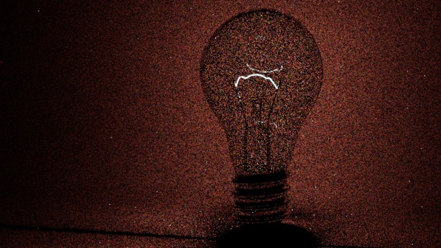

Did you apply the emitter material to the bulb itself?
The problem seems to be if you want a clear bulb and lit filament.
Doug

no the bulb is transparent

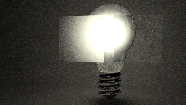

Transparent but frosted? not clear glass.
Works well though if you are after a opalescent bulb - personally I like it - may use it myself :wink:
Left pane of glass with your material - right pane with clear glass.
Edited to update image

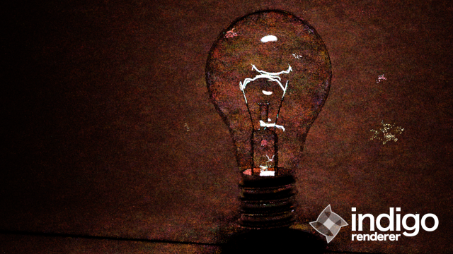

turning bidir and metro off gives better result:

Thats looking better - I didn't try that :-)

I quess it's the quadruple pass through glass with bidir that's messing things up. I also rendered a very small sample up to like 20 000 spp with those on and it eventually did clear up...

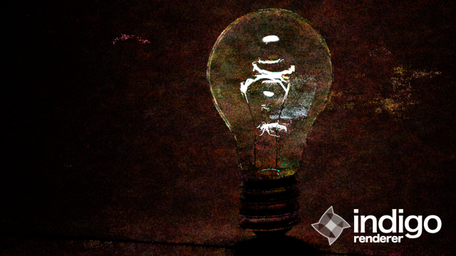

Looks kinda funky with aperture diffraction on :D
BDir and Metro off

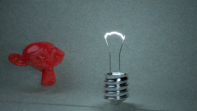

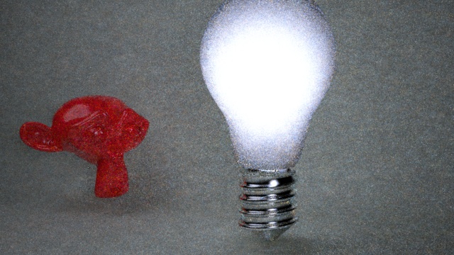

Everything you guys say makes a lot of sense but I still don't get it:
Even though the model is not a 100% perfect (modifiers not applied, too big, glass to thick...) this SHOULD work!
I assigned other materials (one of the famous schott db without cauchy b to be precise) and it works actually (just need higher ev adjust and a little higher iso). So it seems to be a material problem that I don't get.
First picture is everything untouched, exept the glass material.
Second picture is with inner faces of the glass removed and ghost glass mat applied.

I made two more tests and I think the answer is: Your glass ist just way too thick. If you just remove the inner faces of the bulb, your material works fine :wink:
Or just scale everything to real-world-size.

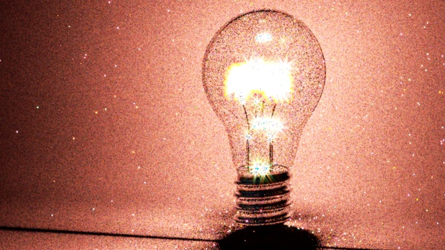

I know it's less accurate but it looks better to me if I delete the glass around the filament but leave the bulb - clears up faster.
benn
Posts: 1046
Re: Can't get light bulb to work
Post by benn » Tue Jul 14, 2009 11:30 am
Here are my renders:
benn
Posts: 1046
Post by benn » Tue Jul 14, 2009 11:33 am
And without the glass:
