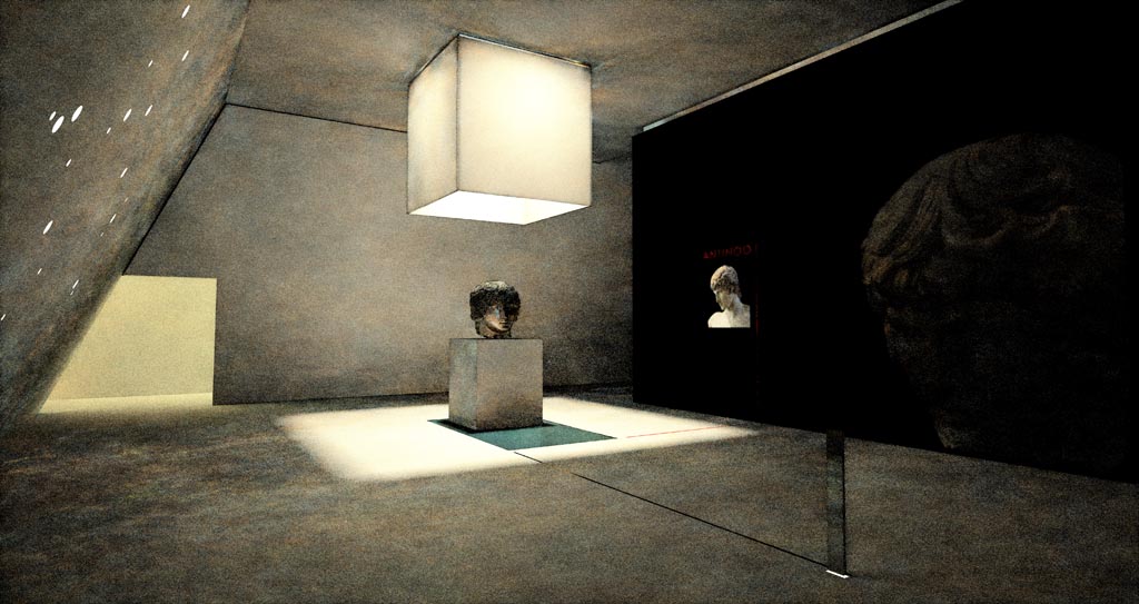

Hi to all.
I want to know the easiest way to reduce noise in my renders.
How can I reduce this noise ?
PS the original render is 5000*2600 px.
Remove Noise
Remove Noise

Two options:
Leave to render for longer, or render on more machines at once.
Reduce materials in the scene that are slow to render, such as whiteness above 0.8,0.8,0.8 or subsurface scattering materials, add exit portals to increase render speed.
Are you using Indigo 2.0.8? It is substantially faster to render.

...and your render needs to cook a lot longer
If there is very few noise left, you might try a noise-reduction software like neat image. But it doesnt' work well with that amount of noise. But some people do think it is perverted to use this kind of software with an unbiased renderer, namely the makers of this nice peace of software

no, it's indigo 1.0.9. I've tried neat image software but I don't like the fog effect that make.
For a better result can I change the render metod from Bidirectinal MLT to MLT ?
