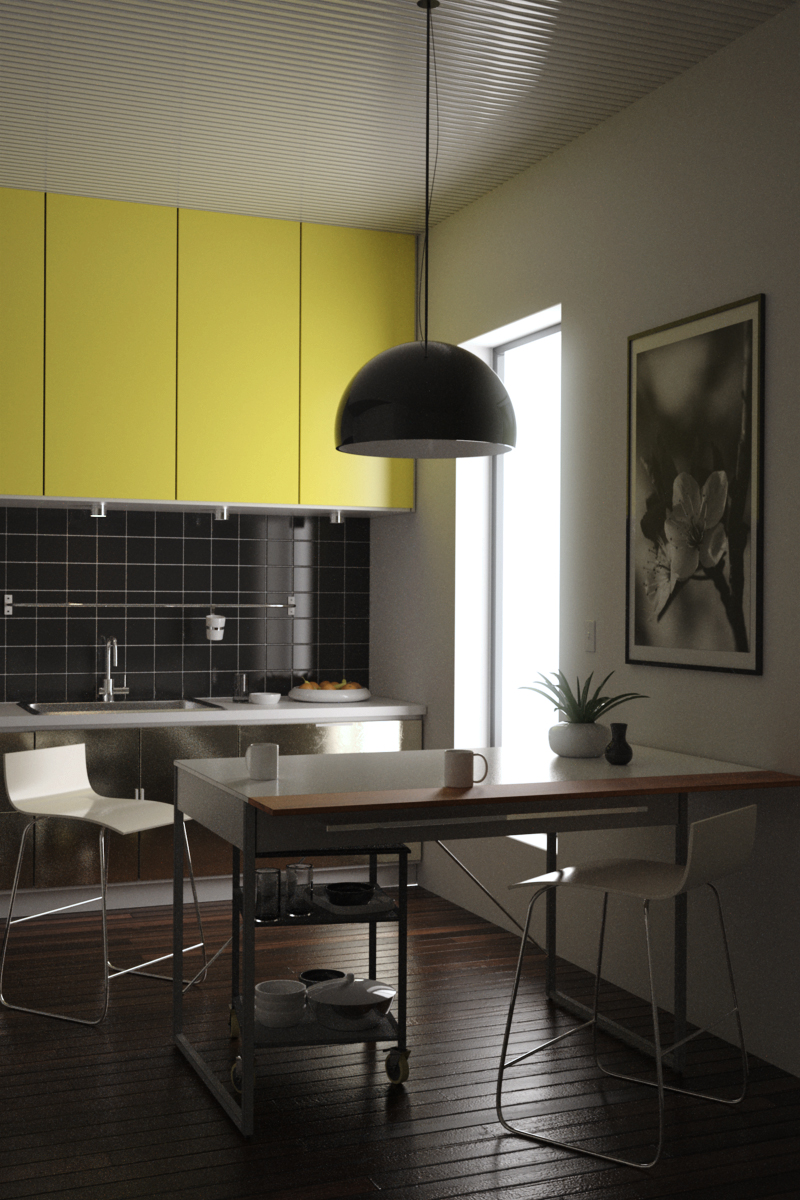

Post by matsta » Thu Jun 04, 2009 10:22 am
beautiful. the windows dont quite seem right for some reason. That bevel is very odd, perhaps round the corners? maybe make the walls thicker so you dont directly see the light source, looks as if light is coming down a tunnel.
Very nice indeed

Post by Zom-B » Thu Jun 04, 2009 12:56 pm
Do U use Exit Portals Godzilla??? It seems you don't, your image is a little bit to noisy for so long render.... tell us something about your rig!
Exit Portals will make your dream come true 8)
(also avoid pure white colors... use max of 80% (RGB 204) for faster rendering)

Post by Zom-B » Thu Jun 04, 2009 8:41 pm
Godzilla wrote:I've no idea what an "Exit Portal" is. :?
I have heard the word before, though, care to explain?
Exit Portals are simple plain meshes that cover every opening of your interior to the outside.
By defining your mesh as a Exit Portal, Indigo knows wehere the only holes are for your envoirement light, and concentrate on these, instead of shooting a lot of rays in space that wont hit the windows or other openings in your scene and are not relevant for you!
Be aware, that no geometry gets rendered behind these exit Portals, only light sources (also EnvMaps), also take care that the mesh normals face into your room to work probably!
I hope this helps for the start... some info about your exporter would help to show you where exactly you can setup exit Portals in your 3D app!
And Finally, just as Ono told, use Indigo 1.1.18 (or the 2.0.6 demo) :wink:

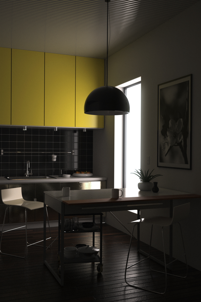

Post by Godzilla » Sun Jun 07, 2009 5:35 am
Did an overnight render, 13 Hours & 9000 SPP later, with some post-pro in photoshop, this is the result I got.
Worthy of the "Best of Indigo"? :o
Re: Kitchen Interior.
Post by suvakas » Sun Jun 07, 2009 9:35 am
Looking good.
A bit too dark maybe? I'd use a secondary light source for the left side to brighten the place up a bit.

Post by Godzilla » Sun Jun 07, 2009 9:42 am
Better?

Post by WytRaven » Sun Jun 07, 2009 1:53 pm
I preferred the dark one myself. Not just preferred but loved the dark one. It has some real mood to it.
Like when you get up at 6 in the morning to get ready for work, walk into the kitchen and haven't turned the lights on yet.
