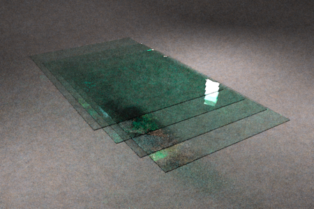

Good day gentlemen.
I'm fascinated by Indigo, even though I am inexperienced and lacks many things to learn.
I need to create a material like glass or like this:
First try assigning TintedGlass, but not like when you go up the value to reflect
begins to look like metal and is not what I need.
I went to try some MaterialDataBase and materials here (Topaz, Emerald, SafetyGlass)
but none helped me.
I'm using Skindigo 2.012b • SketchUp 7 • Mac OSx 10.6.1 • and made the change on file extension .PIGM by. IGM
Could someone help me?
In advance many thanks.

Hi ideas_arte. Try this one: specular transparent material with IOR 1.57 and "your green color" absorb gain 5.0. Here what i've got with these settings in Blendigo (1.4m x 2m x 0.008m) :
<scenedata>
	<medium>
		<name>green_glass</name>
		<precedence>10</precedence>
		<basic>
			<ior>1.57</ior>
			<absorption_coefficient_spectrum>
				<rgb>
					<rgb>5 2.13177 3.34433</rgb>
					<gamma>2.2</gamma>
				</rgb>
			</absorption_coefficient_spectrum>
		</basic>
	</medium>
	<material>
		<specular>
			<transparent>true</transparent>
			<internal_medium_name>green_glass</internal_medium_name>
		</specular>
	</material>
</scenedata>

The tinted glass preset in SkIndigo (like all media) requires that you model your glass true scale. If your glass is about 8mm-13mm thick it should look fine. If you want more color, increase the opacity slider in the SketchUp material editor. This is like increasing the 'gain' of the absorption.
Also, PIGM importing does not work yet on Mac. You have to first extract the IGM and then you can load it into SkIndigo.

@ Whaat: just gave it right. Now everything is perfect.
