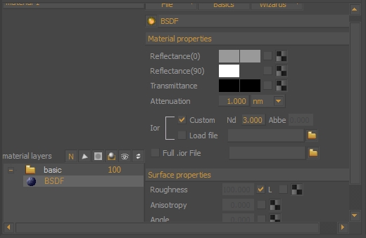

Nice. Skindigo isn't up to date but I can still play with the material editor :) No automatic previewing? :( It would be nice to atleast have be able to enable it in the options menu. It would also be nice to enable automatic saving as well as automatic rewriting (whenever it saves the next version of your preview, it would rewrite the previous version.) It should update your saved file every time it updates the image though (there probabaly wouldn't be enough difference), but when it does do so (once every few minutes (there should be a sublte notification of it in the lower right hand corner. If the resulting image is very big, maybe even overlay a progress bar with this notification. Another idea I had was to be able to right click or left click the material preview window itself to save the render to an image. Maybe have 3 little "jpeg", "gif", and "bmp" buttons overlayed to save to the respective format? How about having "pase/resume" buttons that fade in when you mouse over the upere right or uper left hand corner of the render preview window?
I think what's confususing many people is the lack of familiarity. There are the little things like the under lined materials that sort of make things look a little intimidating. I think the main thing is that, with most material editors, the properties for each material attribute are readily available and here you have to "open up" each attribute to gain access to their properties. The problem with this is that, once you do this, the amount of information you are faced with can be a little overwhelming. There seems to be alot of unused space too, and the concentric boxes that are used to seperate parts of the hierarchy are pretty distracting too imho. All in all, I think the material editors left hand pane is what is confusing most people and is it's biggest weak spot imo.
Also, the color of each property should be at the top of each section imho. Also, it would be nice if we could choose between inputting the values a RGB, HSV, etc.
Notice how in the attached shot of the silo editor ("material 2"), the set of currently created of materials is represented visually, as opposed to having a list of materials. Why not represent each one with a small icon, and have a Windows vista style bar where you can click and drag to increase the scale of the icons?

- material2.jpg (21.83 KiB) Viewed 6001 times
- material.jpg (56.24 KiB) Viewed 6005 times

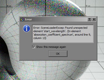

Setting either 'regular' or 'irregular' in the 'absorption_coefficient_spectrum' of a media gives the following error:
