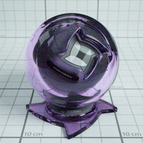

Post by CTZn » Wed Mar 18, 2009 4:10 am
Eat it crude then :lol: (edit: it's better cooked now)
You can see the effect of the phase function: scattering red and blue components are propagating almost straight inside the medium, while green has a razing scattering angle. Of course both emiters are of plain white emission.
Edit: directly inspired by http://www.indigorenderer.com/joomla/co ... temId=6578
PS: Unlike what I formerly stated, since this shader heavily relies on phase function it can be called "polychroic" (can it actually ?), dichroism is effectively reached because R and B components have the same phase param; It's not simply discriminating between (non) absorbed light and scattered light.

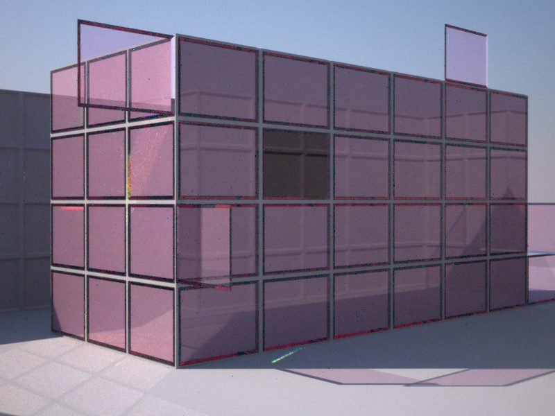

Post by Kram1032 » Wed Mar 18, 2009 6:44 am
pretty nice test :D

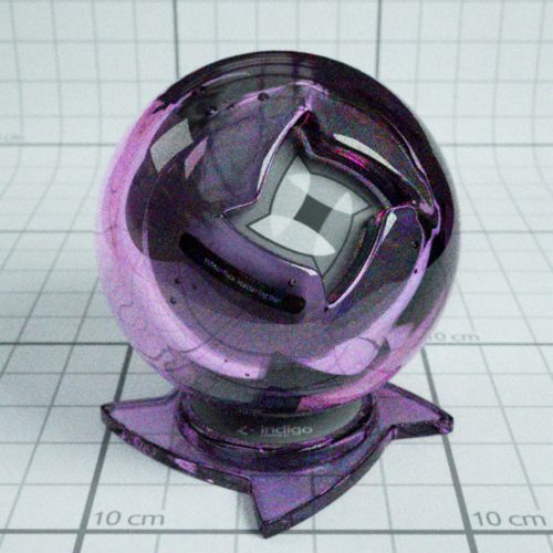

Nearly final, you can save it as an igm file.
Interesting one for optical coating, settings were lost amongst multiple tests ;(
actual material

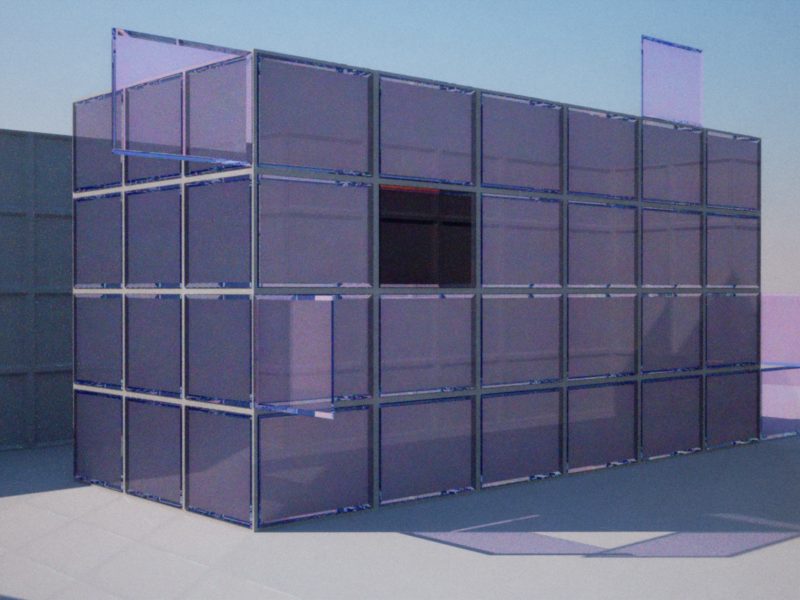

Some more tweakings and I upload it.
ior changed to 1.72, panes are about 8mm of thickness
soft dichroic glass

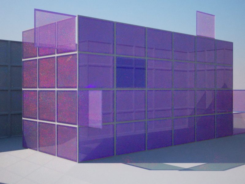

edit; more references for dichroic glasses: http://www.worldglassnet.com/pages/appG ... subcat=All
PostS.: I edited previous codes, they weren't matching the matDB naming convention, I think that's better now. Will do a last check before upload.
closer to usual dichroic arch glass I guess

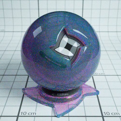

A characterized one
