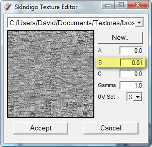

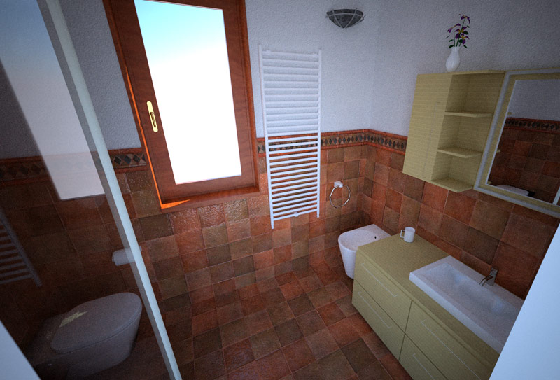

I have tried to change the bump parameter in the material editor window with a texture material, but i always have a smooth surface...
I have to make the stucco wall and the brick pavment..
Sorry for my "italian" english :oops: Thank you!
All the surfaces are too smooth!

Did you specify a value for the B parameter ?

I specified the B parameter but seems don't work.....
The material get darker and... strange!

did you want bump or displacement? what were you expecting?

Poscia, l'effetto è giusto, solo che hai messo un valore di bump troppo alto: tenta con un valore molto più basso, tipo 0.003/0.005: skindigo è MOLTO sensibile ai valori di bump.

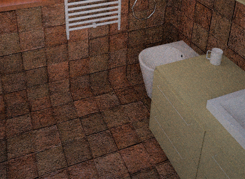

Then, the bump effect is all right: simply your bump value is way too high: try with a much lower value, 0.003/0.005: skindigo is VERY sensible to bump values.

The <b> parameter is in meters, so 90% of the time values are under 0.1. Being subtle, bump mapping needs longer renders than you posted to be visible; to test it remove other objects in scene, or apply to them a gray diffuse. The test is faster if you remove all color information in scene (bump only).

24 hours of render and now it's all Ok!
I found some Whaat's tutorials so i understand the meaning of all parameters...
Now i'm beginning to enjoy this way of work!
Thank you Pibuz.. I'm using a 1.0.9 Skindigo version.

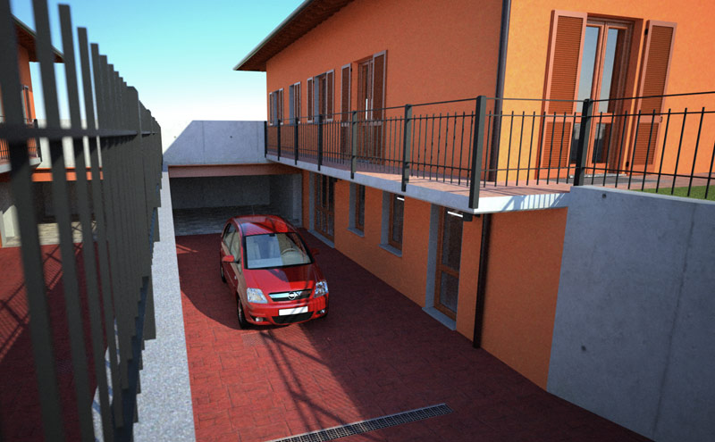

Post by Pibuz » Mon Jan 19, 2009 3:19 am
Ehi, buon risultato nicola!
Senti, una cosa che potrebbe aiutarti: hai usato exit portals per questo render? Sono utilissimi per ridurre il tempo di calcolo per gli interni..

Ehi Nicola: nice result!
Listen, something that could help you: did you use exit portals for this render? They're very useful to reuce render times for indoor scenes..
