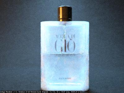

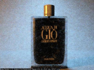

I have been trying to render a Gio bottle, but i have run into a little problem..
I have 2 different renders here.. one is just a glossy transparent for the bottle, but in the second I have tried to add a little sss but it turns the inside black..? :? Any ideas to why that happens..?

The liquid inside should overlap the inside wall of the glass - you can see a good example at the end of this document: http://www.indigorenderer.com/joomla/in ... &Itemid=62
Also check your material precedence. Air is equal to one. Your liquid should have the highest precedence, followed by the glass.
Drinking glass example: glass 10, drink 11, ice 12
And, as always, check your normals.

It was actually a stupid normals problem.. The precedence was set right, but the normals on the inside of the glass was pointing outside.. stupid stupid me.. :) Will post the updated render when it has cooked a bit longer.. Things are SLOW on this little laptop..

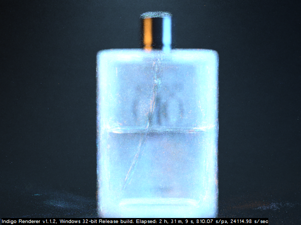

Post by hstokholm » Thu Aug 14, 2008 3:51 am
hmm are you sure..? I think this looks quite right..
Still have to work more on the materials though.. The text should be much clearer and the glass is still not quite right...

Post by PureSpider » Thu Aug 14, 2008 6:05 am
I am sure... you need to set glass > liquid for so that your glass replaces the overlapping parts of the liquid... the way you did it is wrong as the liquid replaces the glass that way...

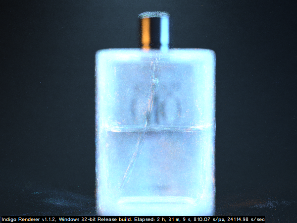

Post by hstokholm » Thu Aug 14, 2008 12:36 pm
Okay thanks.. Changed it now.. This one is out of focus but i kinda like the look of it...
Like a jigsaw piece without a puzzle
Post by Borgleader » Thu Aug 14, 2008 12:47 pm
It's kinda cool, yet we can't see the text at all.

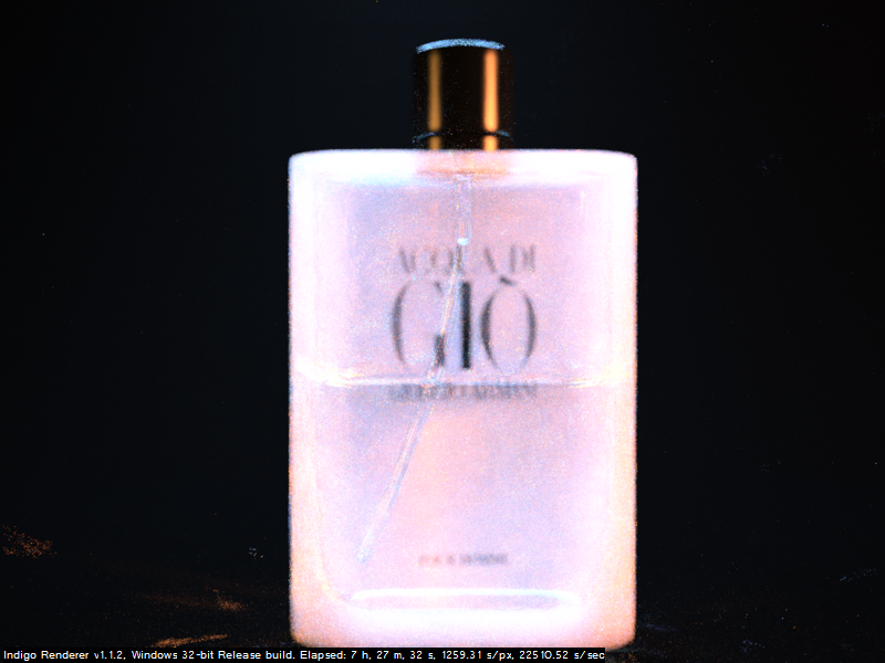

Post by hstokholm » Thu Aug 14, 2008 9:51 pm
I know I just can't seem to get it right... another try:
Post by Borgleader » Fri Aug 15, 2008 12:02 am
Well that definitely looks better. But I'm puzzled as to why the whole image still looks extremely grainy at such a high spp count. I mean at 1259 i would normally expect the image to look clearer.
