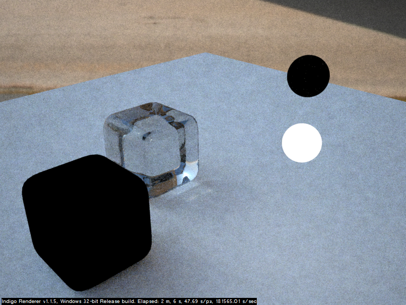

when I duplicate and then I reflect an object, the turning out objects are black :(
this is a bug?

object with duplicate and reflect

Flip the normals.
Post by CTZn » Sun Jun 15, 2008 12:33 am
because reflecting a geometry does so.

This is a bug with instanced transparent materials.
If you use Blender then use shift-D to make a duplicate of the object and your object will look fine (do not use alt-D.)

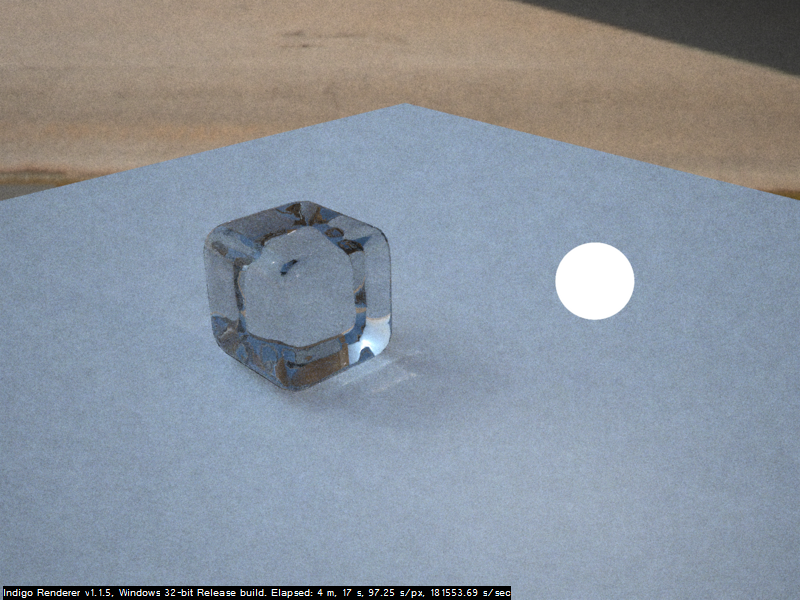

Post by zuani » Sun Jun 15, 2008 1:56 am
thanks a lot guys! :D :wink:
I made confusion with the commands in blender, is everything to place now!
