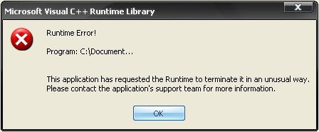

So... How can I get an environment map to work? I get a 'runtime' error when attempting to render.
Thanks in advance :)

It would be best if you could post an image of the error you encounter, so we can see what's going on...
The first thing that pops in my mind is that you're could be using an hdr image instead of an exr. You know what an exr is, isn't it? However, you need to convert your hdr images to exr for them to work in indigo. "Picturenaut" software will fit your needs :D

Post by Thom » Wed Apr 23, 2008 12:20 am
Here's the error.
Post by Pibuz » Wed Apr 23, 2008 12:24 am
..no idea of what it is...so sorry :oops:

I converted the .jpg image to .exr and I get the same error.

as far as the error goes, I'm wondering if you have it set correctly in Skindigo? Do you have the "Enviroment Map" radio button checked? It is possible to Browse for an env. map but not have the button checked, might cause an error.

Thanks. I have obtained an HDR image and set it as an environment map in Indigo. However, I am prompted with an error message, stating that the file is not valid.
