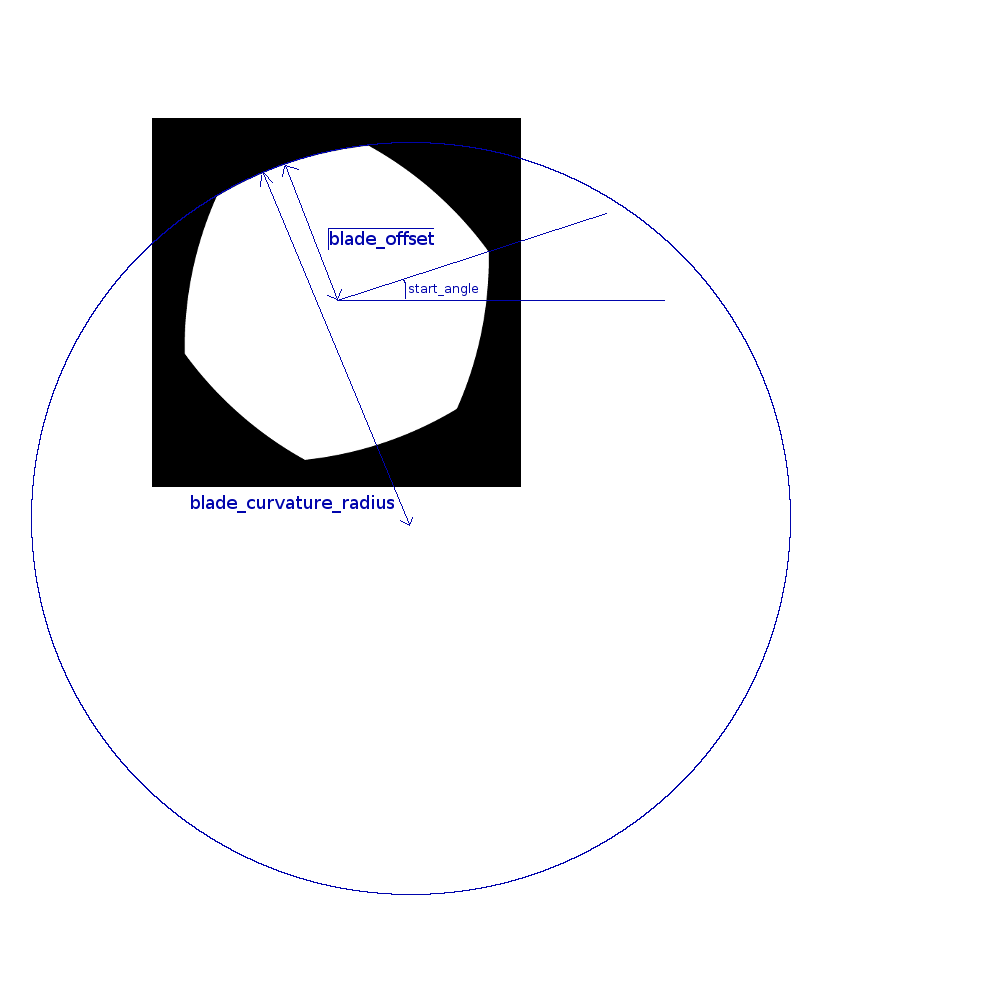

The second type of aperture shape specification generates an aperture visibility map using some diaphragm blade drawing code.
 <aperture_shape>
		  <generated>
			  <num_blades>6</num_blades>
			  <blade_offset>0.4</blade_offset>
			  <blade_curvature_radius>3.0</blade_curvature_radius>
			  <start_angle>0.2</start_angle>
		  </generated>
</aperture_shape>

Post by OnoSendai » Wed Nov 28, 2007 6:13 am
Added a diagram of how generated_aperture works.
