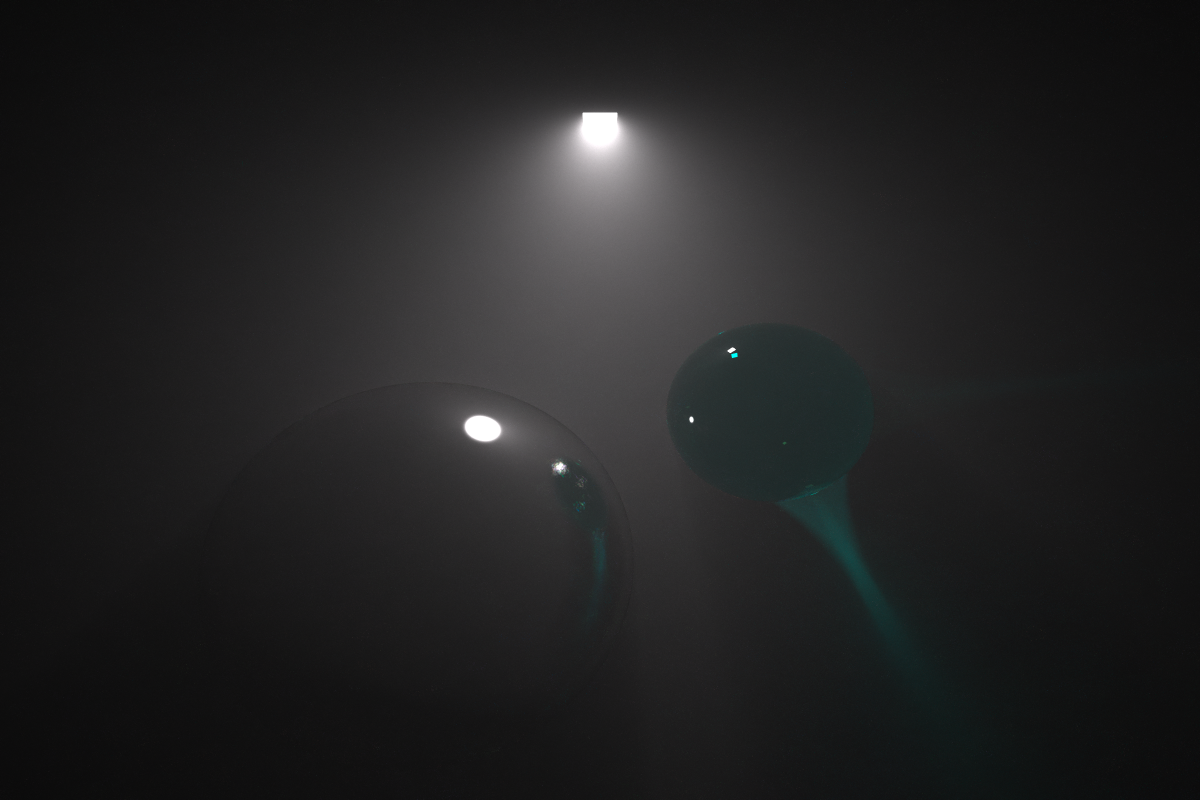

Hi Suvakas...
how can obtain this like imge with your exporter ?
Post by OnoSendai » Tue Mar 13, 2007 8:27 pm
hehe u must have rendered that for a while :)
tizxx
Posts: 116
Joined: Tue Jul 04, 2006 1:50 am
Post by tizxx » Tue Mar 13, 2007 9:27 pm
Only 15 hours 22 minutes and 17 seconds...
on a Intel Core 2 Duo E6700 - 2.67 GHz
272518.3894 samples...
Ono I love your render engine ...
Post by OnoSendai » Tue Mar 13, 2007 9:32 pm
Gotta get me one of those Core 2 Duos :)
Post by suvakas » Tue Mar 13, 2007 9:57 pm
Nice! To get the same noise level I would have to render it like for a week or so on my old AMD. 8)
Well..what can i say, you have to use the same technique that is used in this example scene. For example make a large box. Put everything inside this box. Give the box an SSS material with the precedence of 2. Every medium that is inside that box must have precedence higher than 2. Put the camera outside the box. Render.
It's not so much related to exporter. The Indigo Manual is a really good place to get help. I recommend to read it. :wink:

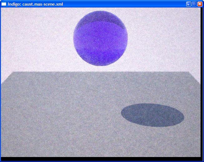

Post by tizxx » Wed Mar 14, 2007 1:48 am
This is the working in progress after 31 minutes
142000 samples ...

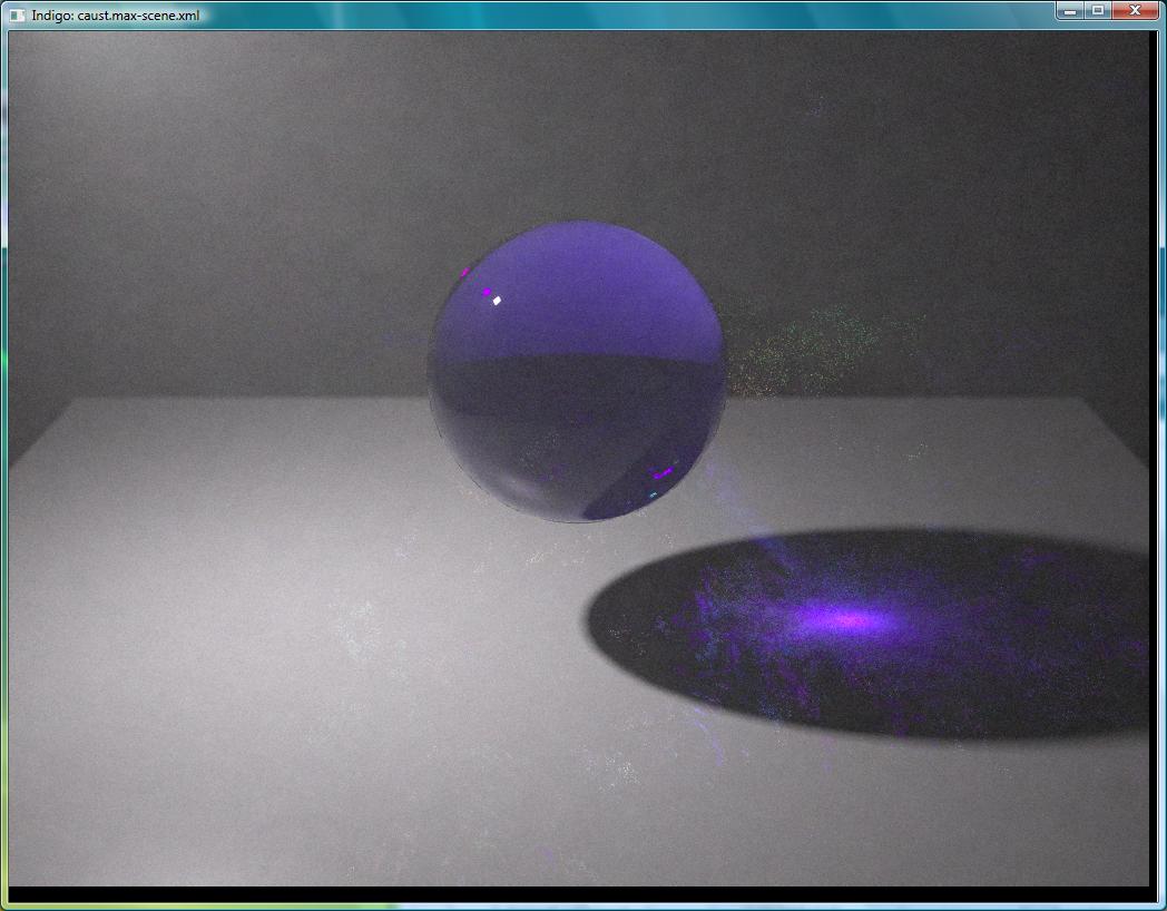

Post by tizxx » Wed Mar 14, 2007 1:56 am
Ono can you post a simple scene ... ?
so we can see caustic volumetric with sun light
tizxx
Posts: 116
Post by tizxx » Wed Mar 14, 2007 2:22 am
This is the same scene with SUN LIGHT enviroment
The caustics are not present anymore...
