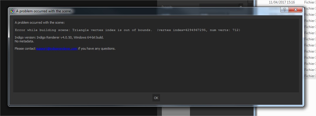

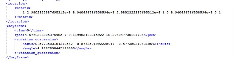

something weird
I have to add and "edit mesh" in the top of the stack to avoid any "Triangle vertex index is out of bounds. "
The nature of the object is jut a box converted in edit poly and edited a bit.
The diference is into the location/position definition and maybe also the mesh itself.

^ I can confirm the above. I get the same issue.

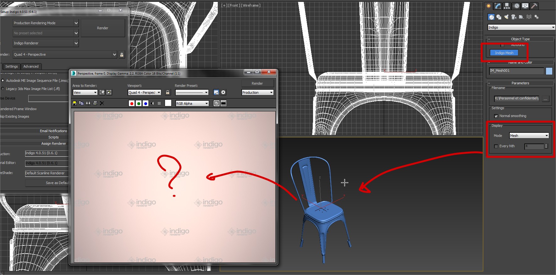

When this super uber cool feature could work (for real) ?
(An export confirm that the material is created, but not the link to the mesh neither the "model2" )
Then could you add a "scale" variable in the interface for that?
errare humanum est

Jay-ko wrote:When this super uber cool feature could work (for real) ?
I fixed this for the next release ( 0.6.8 ). You should be able to apply any scaling by scaling the object in max.

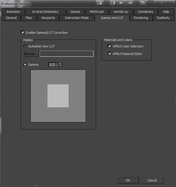

With the gamma option - yes - if one uses Max without gamma on, when selecting materials and applying colour, Indigo renders an output that would appear to still have gamma switched on. It makes colour picking a bit tricky. This also affects textures. For consistency, I think it would be better if IndigoMax had a gamma slider or toggle etc, that allowed the user to choose.

Post by tar_gniK » Sun Nov 26, 2017 12:51 am
That's interesting - I wasn't aware of IndigoMax using Max gamma. Although to be fair, it was more of an issue in the early version of IndigoMax compared to now.
But there is a quick test that can be recreated - open GIMP/PS and make a new image with a solid colour (for example 190, 0, 0).
Making a new material and using the colour picker to pick the solid colour, with gamma off, picking the colour it reads back as 190, 0, 0.
With gamma on, picking the colour, Max reads back 133, 0, 0.
If I then leave gamma on, and render, then Indigo renders the colour as if gamma is off in Max. The log window reads Master gamma: 1.0.
I then verify this by using the Pick Material in Indigo, and comparing the swatches in Max and Indigo. And they are different.
So if a client asks for a specific shade of colour for an interior wall for example with a swatch, I usually use the colour picker. But then I get confused, because the output is different in the Material Editor and in Indigo.
Unless I'm misunderstanding how gamma works. :?
Max's gamma options can be found at Customize - Preferences.
