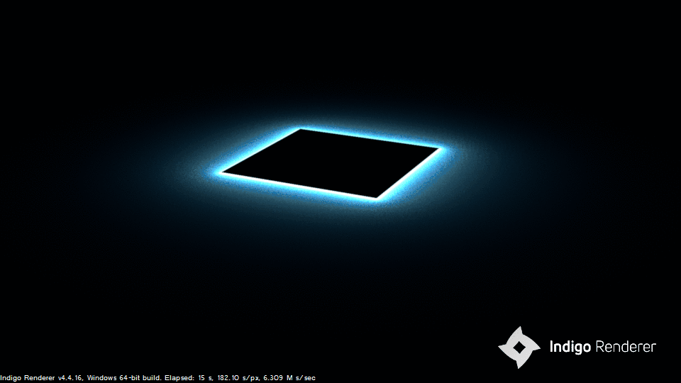

Simple test animation shows fine here. Frame names saved by frame numbers located in "C:/tmp/[Scene-Name]"
Tested using: Blender 2.83.16 LTS w/ blendigo-4.3.0-3adc22b-master (exporter) & Indigo Renderer 4.4.16.
Edit:
Same test also working with Blender 2.92, Indigo Renderer 4.6.0 & integrated Blendigo exporter.
