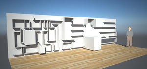

Hi Indigo,
I have made a file in SketchUp and use your program to render it.
Is it not possible to get a higher resolution than 72 dpi, or a bit sharper than the one i made, it's very blury and not sharp!
It render for about 24 hours, and not finish :cry:
Best,
Jesper :D

Post by Oscar J » Thu Aug 28, 2014 1:54 am
The resolution in Indigo is not measured in DPI, but in pixels wide and pixels high. Under Render Settings, you need to crank up the resolution to the double, for example. That will make the image more defined. Leaving it to render for several hours won't make the image resolution higher! For a scene like that, half an hour should be more than enough.

Post by Juju » Thu Aug 28, 2014 2:04 am
Also, Indigo does not stop rendering, it keeps on going... You will need to stop it manually or set a SPP value limit. See the FAQ's and manual.

Post by Zom-B » Thu Aug 28, 2014 2:35 am
Also set your camera f-stop to 8 to avoid Depth of Field blur in your scene.
Use supersampling together with the sharp downscale filter for sharpest output without ringing!

Post by Smukkehansen » Thu Aug 28, 2014 11:57 pm
Hey ;-)
Thanks for all you help, it much better now ;-)
A little question, do you know how I can lighten the shadows ? I can't find where! ;-)

Post by Zom-B » Fri Aug 29, 2014 12:00 am
Hey ;)
There is no direct shadow-density-control ;)
You need to change tonemapping, or set another Lightsource to bright up the area ;)
You also can render Sun & Sky in different LightLayers and reduce Sun strength for also lighter shadows (and less sun light!) ;)
