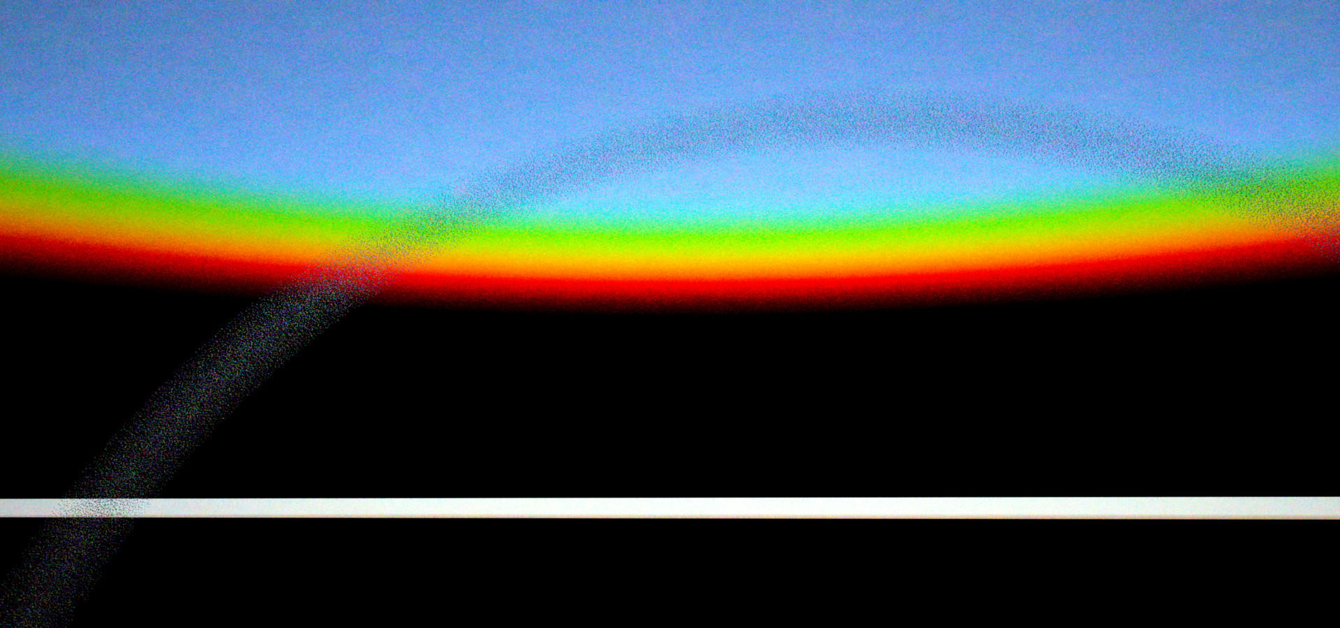

Hello, I am need of assistance in creating the oh so cliche rainbow arch. I've skimmed through the forums and have learned that it's possible to get Indigo to refract light into a rainbow, although I had had time to read the first few posts. However, I'm wondering if there's anyway I can get that refracted light to travel in an arch (or actually a half-submerged circle.)

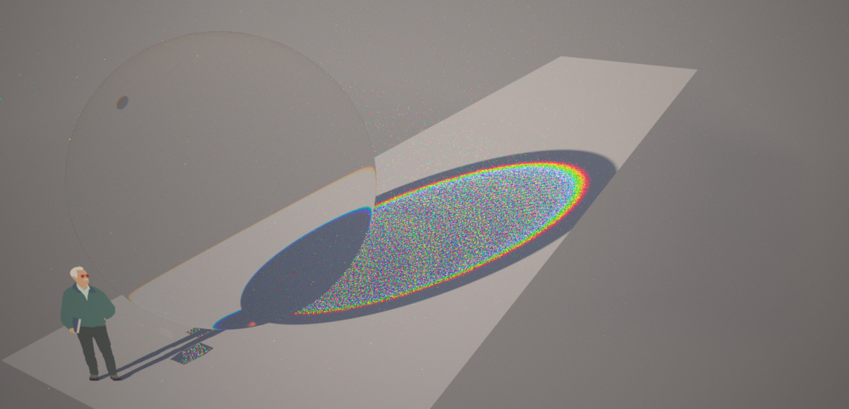

Yes it's what I tried, 4967967 spherical water droplets on aproximately 0 to 50m height, cauchy b coeff 0.003, but I get no rainbow. And a box of sss to do some fog, I tried uniform and RGB. I'm using path tracing with MLT I don't know if it's correct to have a rainbow effect

For now I made several tests, with various settings such as cauchy b coeff between 0.0013 to 0.003 even some to0.1,0.5, or 1; and IOR 1.3, with and without scattering with water spheres approximately 1mm diameter, in spaces from 5m cubic to 200m cubic, seen from far, seen from near, or seen from inside; with FOV from 20° to 88°, the sun respecting the limit of not above 42° up the ground and coming from the back. I tried with SS box fog englobing the scene, uniform and RGB, and I tried without; I tried Reinhard, I tried camera; I used, path tracing with MLT, Bidirectional path tracing with MLT, Bidirectionnal Path tracing. Nothing concluding, I must do something wrong, or maybe it's just not possible to do a rainbow;
I'm reading a paper about making physical simulation to create rainbows in a ray tracer, they talk about techniques such as "Lorenz-Mie theory" and other techniques derived from it; I guess it will not really help me since I'm totally noob with shaders or other things like that :lol: but it's still interesting. But they say one thing, it's that to get realistic rainbow it needs optical effects such as dispersion,
polarization, interference, and diffraction
That's all I've got with those 17Million sphere droplets of 1mm, we see dispersion but no rainbow, maybe I'm doing wrong ?
The most rainbow-like effect I had was by setting cauchy b to the big fog box englobing the scene but that's nothing like accurate
If the sky was a physical wall it would just need a Big sphere of glass to create a rainbow lol

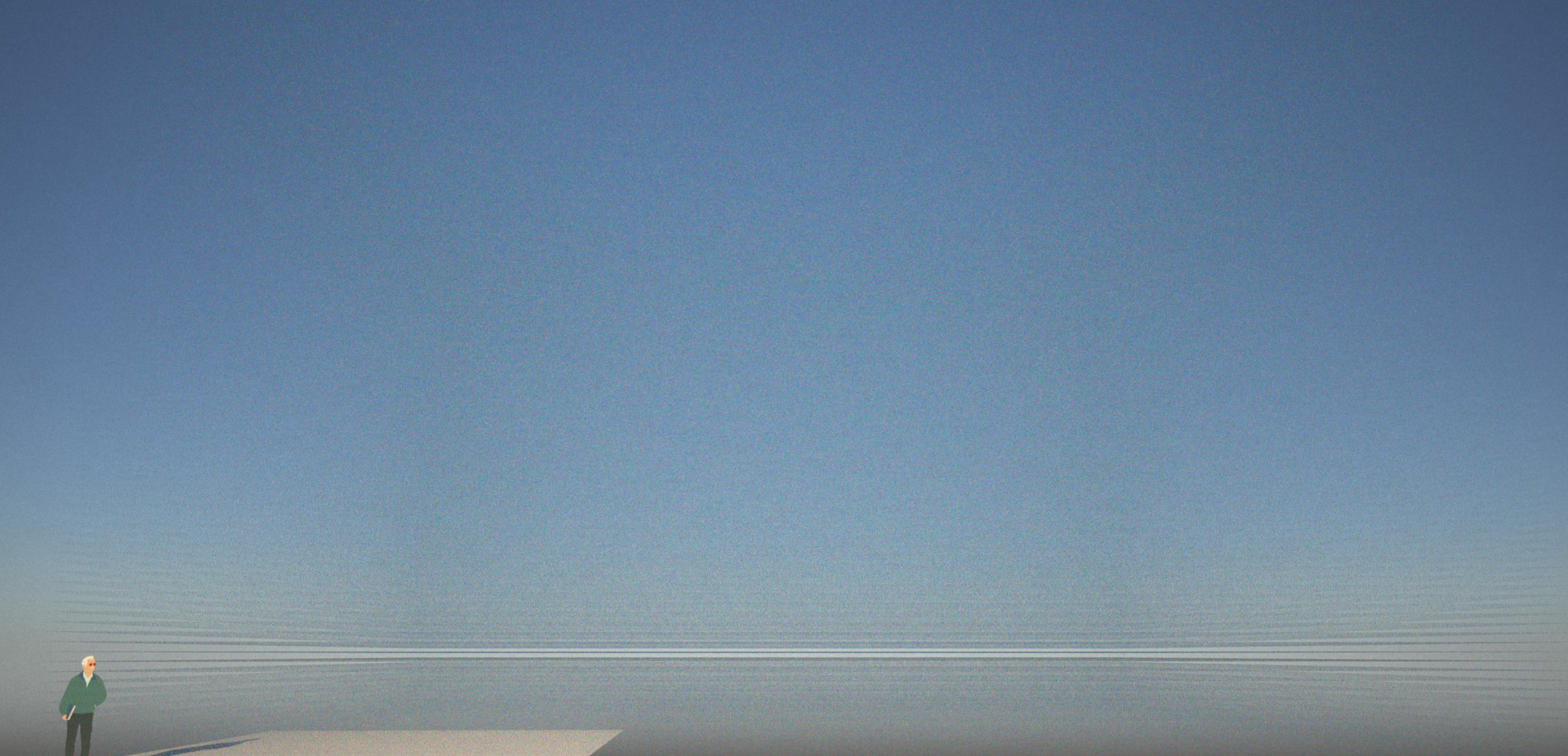

The artefacts in the bottom of the images show that you have reached floating point precision limit. In that case, the rays cannot be calculated accurately inside the spheres. This will clearly be a limitation

In the first image it is not artefacts, it is just that I scattered the spheres on many planes since we can not scatter objects into a volume in Indigo (yet ? ) , the spheres having a water material, and the planes a null material to be invisible. So the lignes and spaces on the bottom of the image are just the spaces between scattered planes were there is no sphere
