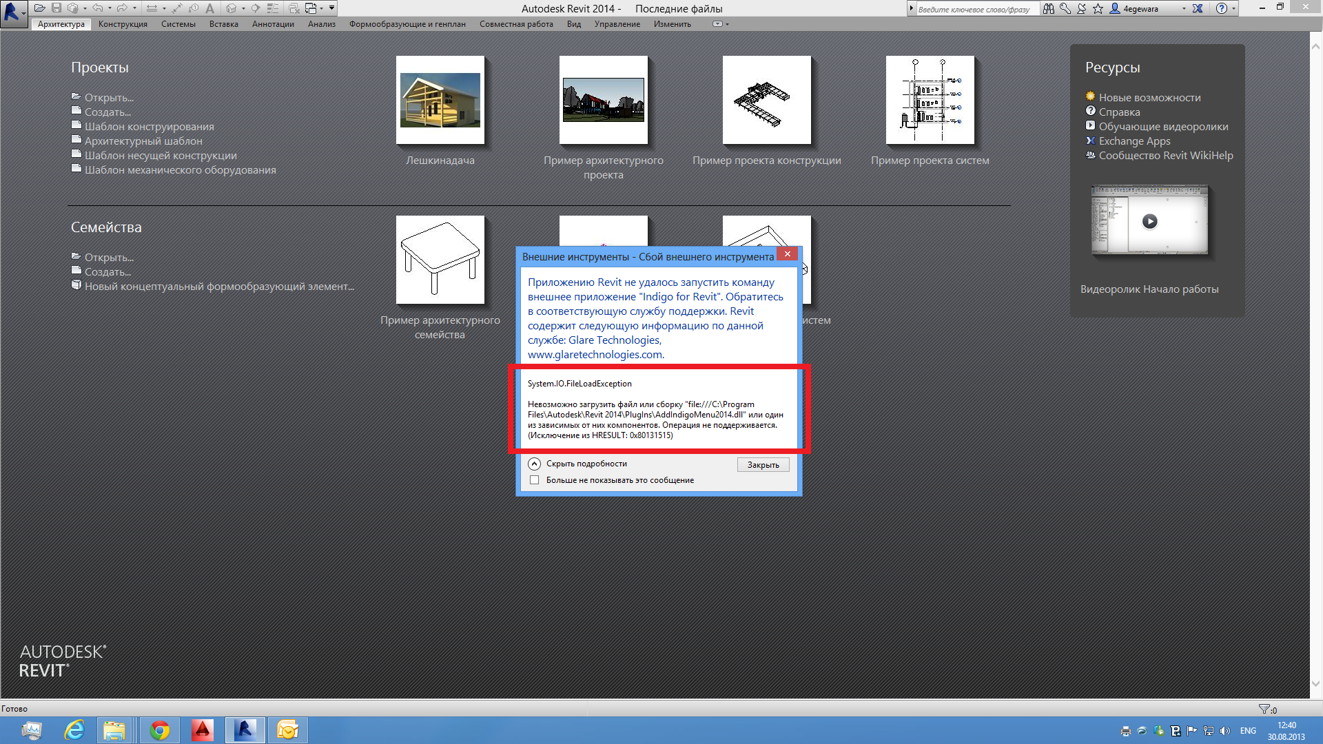

Can't succesfully run Indigo in Revit 2014.
I cant see indigo plugin in Revit Interface, and also Revit posted, that it cant run app
How I installed plugin:
I use Windows 8 platform, so usually, as I Install any programm, i click right mouse button, and then choose "Run as administrator".
When I saw, that Revit cant run plugin, I copied all *.dll files to main Revit folder, and also in plugin folder, but nothing happend. Also I checked ...AppData\Roaming\Autodesk\Revit\Addins\2014 folder
Please, help me to add plugin to my Revit app. May be i doing something wrong, or nor fully.
Best regards. Mikhail/Russia/Novosibirsk

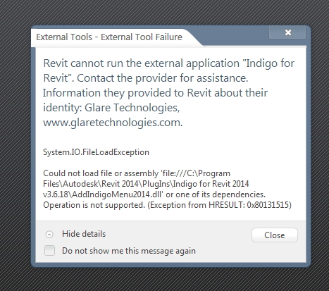

Hi, I believe I've the same feedback as Arkon:
Running:
Revit 2014 (Student Version)
Indigo_for_Revit_2014_v3.6.18 (via Yves Collé link in email)
Installed fine, but when I load Revit up after I get the error shown in image below:
Am I doing something wrong?
Revit 2014 with Indigo_for_Revit_2014_v3.6.18

Post by fused » Wed Oct 30, 2013 12:54 am
fractal.design wrote:Hi, I believe I've the same feedback as Arkon:
Running:
Hi fractal.design,
the DLLs in the beta aren't digitally signed. Windows 8 has this feature that unsigned DLLs will be blocked by default. You then get this error. This is already fixed for the final release.
To work around it, simply select all the DLLs in the Indigo for Revit directory, right click and select "Properties". Somewhere on the bottom of the dialog, there should be an "Unblock" button.
Sorry for the inconvenience.
