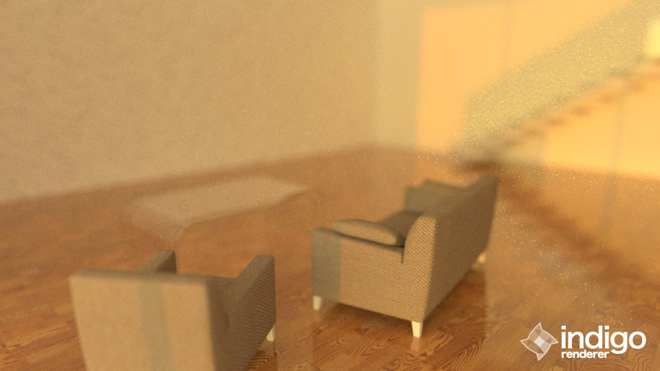

Hi there,
I'm new to Indigo and did my first few renders of an interior test scene.
I noticed a very shallow depth of field, so I tried reducing it by setting the lens to wide angle (25mm), set the Aperture to f/11, turned off auto focus, and focused manually on a foreground object.
But still nothing really changed, except for that the focus now is on the object that I chose...
what am I doing wrong?
Jonas

Post by Zom-B » Thu Dec 13, 2012 11:17 pm
Take care to setup you scene in real life measurements, since camera handling for a puppet-house are different then in a real home ;)
The should also be some scene scale multi somewhere in the settings where you can apply some scale manipulation on export... afaik.

Post by JonasWe » Fri Dec 14, 2012 1:26 am
Thanks for the answer!
For some reason my unit system was changed from metrical to imperial in blender...
