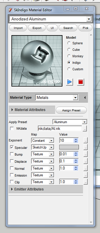

I once made such a material, if I remember right the setup was as following:
Material type: Metal
Specular: light grey color, about 35-40 percent of grey
Exponent: somewhere between 10 and 20 if I'm correct, could be slightly more, but definately not over the 100
I'll see if I can find the renders I made and the corresponding material when I get back home.

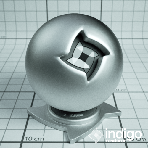

FoXar
Posts: 139
Re: Apple Brushed Aluminium?
Post by FoXar » Fri Nov 09, 2012 6:53 am
Nope I haven't, here's the setup ;)
Cheers,
Roo Evans
