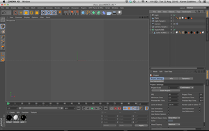

I am new to this forum and Indigo Renderer. I have had a go and got some reasonable results so far using C4D :D
I do have a question though, I took a scene I has made, imported materials from this site and applied them to my model - which promptly disappeared. At least it did in the view port. This confused me (doesn't take much though).
I am wondering what I did wrong?
I am using C4D R13, on a macbook pro 2012.
Thank you for any help you can give!

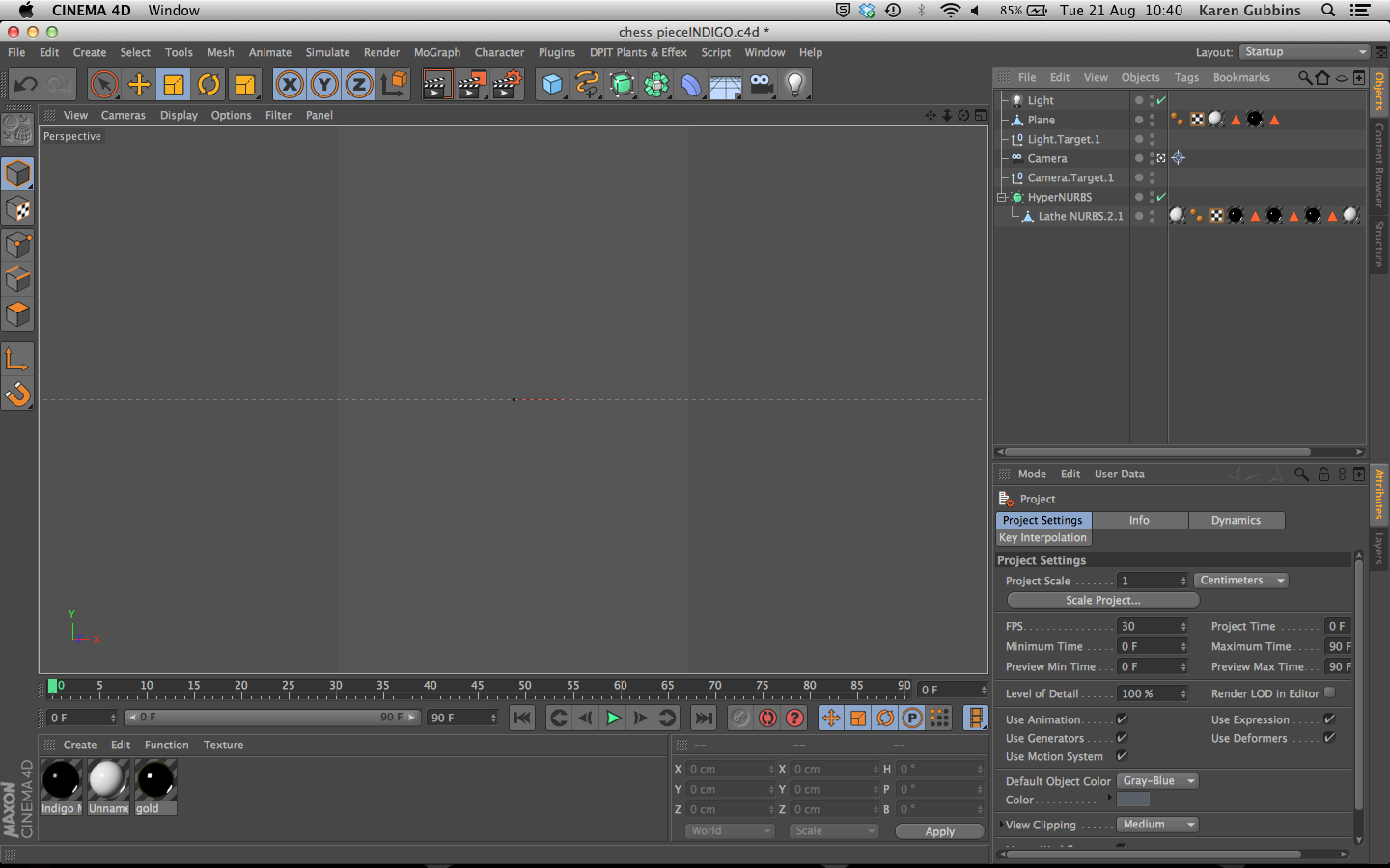

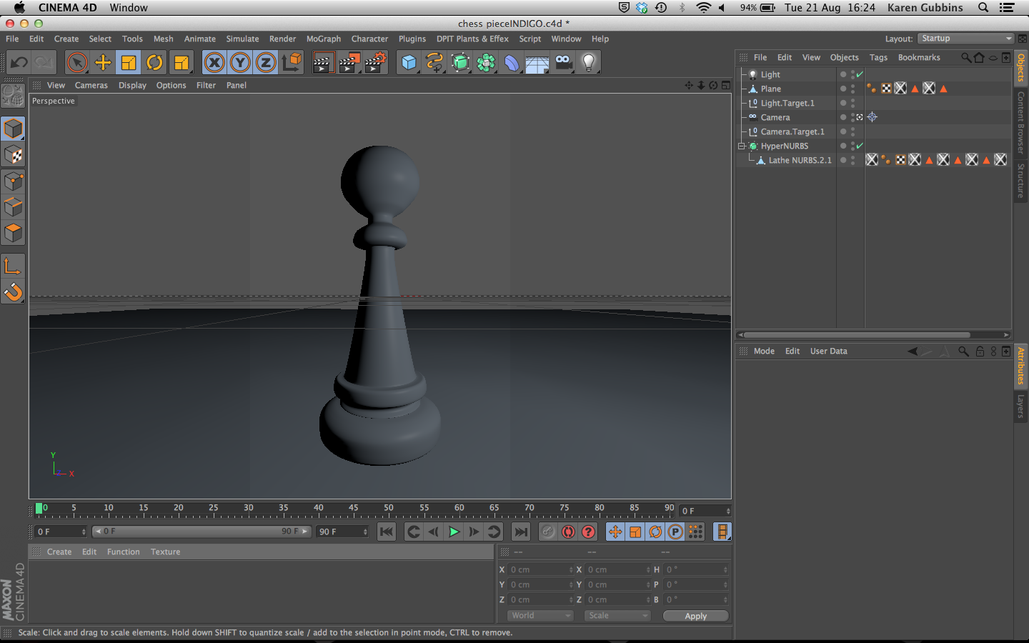

The problem is definitely to do with the materials - if I delete one or more the bit that are not assigned a material reappear. I didn't activate Advanced open GL. It happens if I set the render to the standard render too.

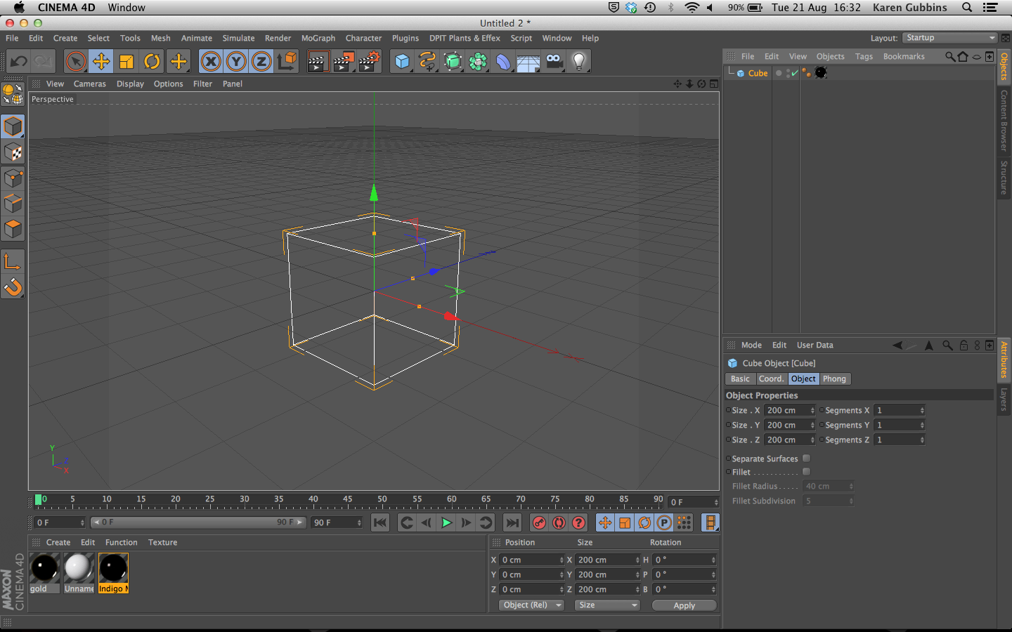

I have tried to replicate it on a simple cube and that disappears too with the same materials...? If I create a new material, that seems fine.
The object is clearly there when you click on its name in the objects manager, but as soon as I click away, poof, its gone!

ah...i didn't think of that! here it is. When I change the materials the model reappears..

poodles wrote:ah...i didn't think of that! here it is. When I change the materials the model reappears..
Ah, ok that sounds like a familiar bug :)
Since R13 (I think) the editor representation of the material does not update immediately for some reason. Looking into it :)
