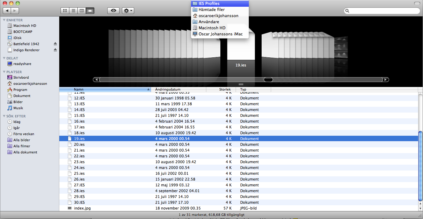

/Users/oscaroerikjohansson/Downloads/IES Profiles/19.ies
I know that this part of the path is correct, but I'm not sure about the other part.
As it says "File open failed", I guess that either it can't read the file itself (even though I've tried many different files), or it just can't locate it on my HDD.
