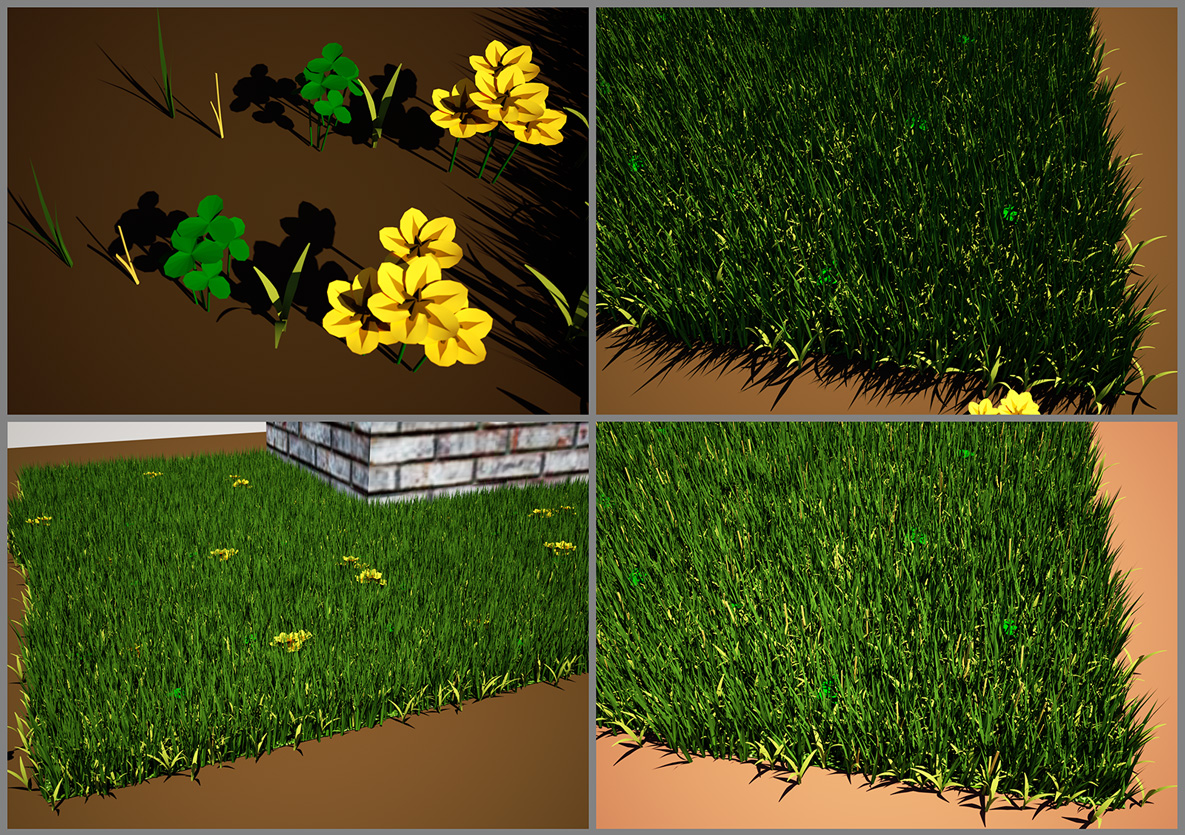

Inspired from the carpet topic I started some tries to use this technique for grass generation. Some nice examples of nature objects are in the gallery, so this simple example can only be a startpoint for further investigations and improvements. I hope that some other SketchUp users try to do so and show their results (renders and models
) here in this topic?!
I attached my example model for this purpose ...

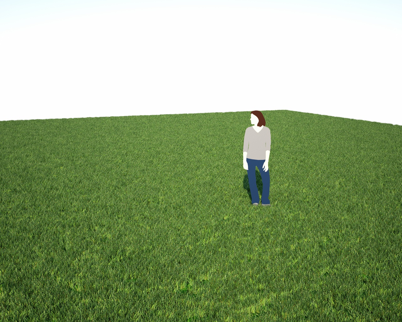

Might as well add my grass in here then - 2 simple componants textured using the summer grass material from the database, one made darker one made lighter for colour variety, then just dummied around using the fur plugin. Works well enough for me

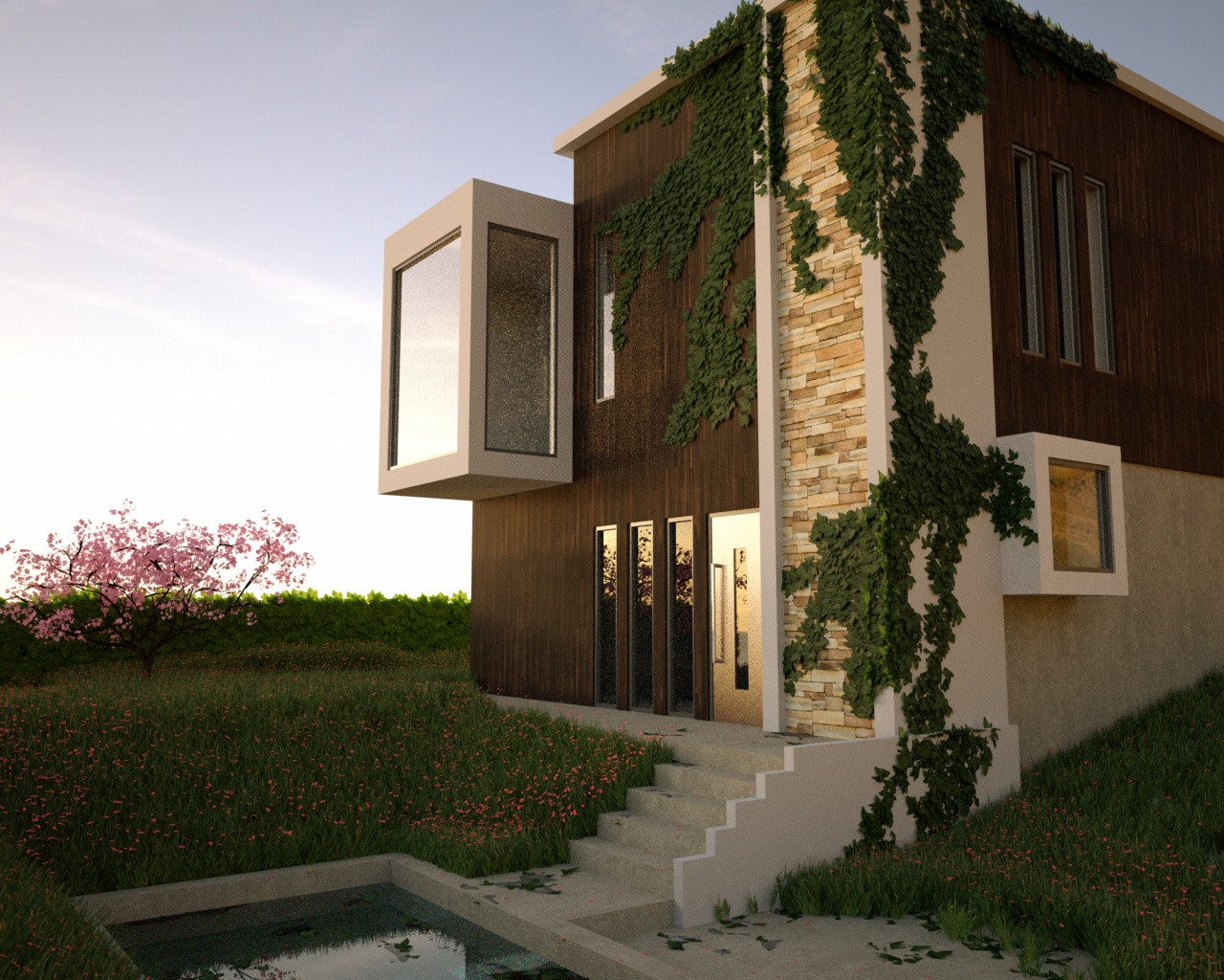

And just for fun (an old one, ignore the rubbish house), you can scatter little components around with the fur plugin and then move up to look as if they're sat on the grass to be flowers, fallen petals, leaves whatever.

The house is simple and not very detailed indeed, but grass, vines, tree and envmap mood are insanely impressing.Bosseye wrote:And just for fun (an old one, ignore the rubbish house), you can scatter little components around with the fur plugin and then move up to look as if they're sat on the grass to be flowers, fallen petals, leaves whatever
