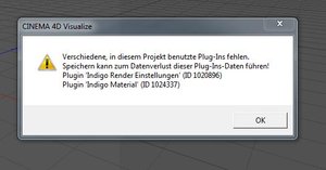

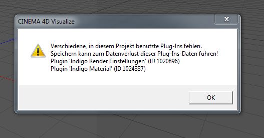

I ignored that and tried to open an indigoprojekt. The reaction fram cinema was:
yes, i installed the r12-version.
But like I said, the installation (copy the 3.0.15 folder into the plugins-folder) shows no effect.
I have deletet the older cindigo-folder first. Was that a mistake?
I cannot use the 3.0.15. Cinema just can not see it. The console is and remains empty.

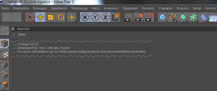

Re: C4D R13 + Cindigo 3.0.11: Problems
Hi Yves,
thanks. After installing the Visual C++ 2008 redist package
Cindigo shows up in Cinema R13!!!
There was also a note in the konsole then. See picture.
After that we tried to render. Problem is still there, I think.
After 5 Minutes still no picture. Indigo says it is updating
image, bus nothing happens. Black screen.
We will render over night so see, if there is a picture-update
then.
Still we cannot use Indigo with R13.
Daniel

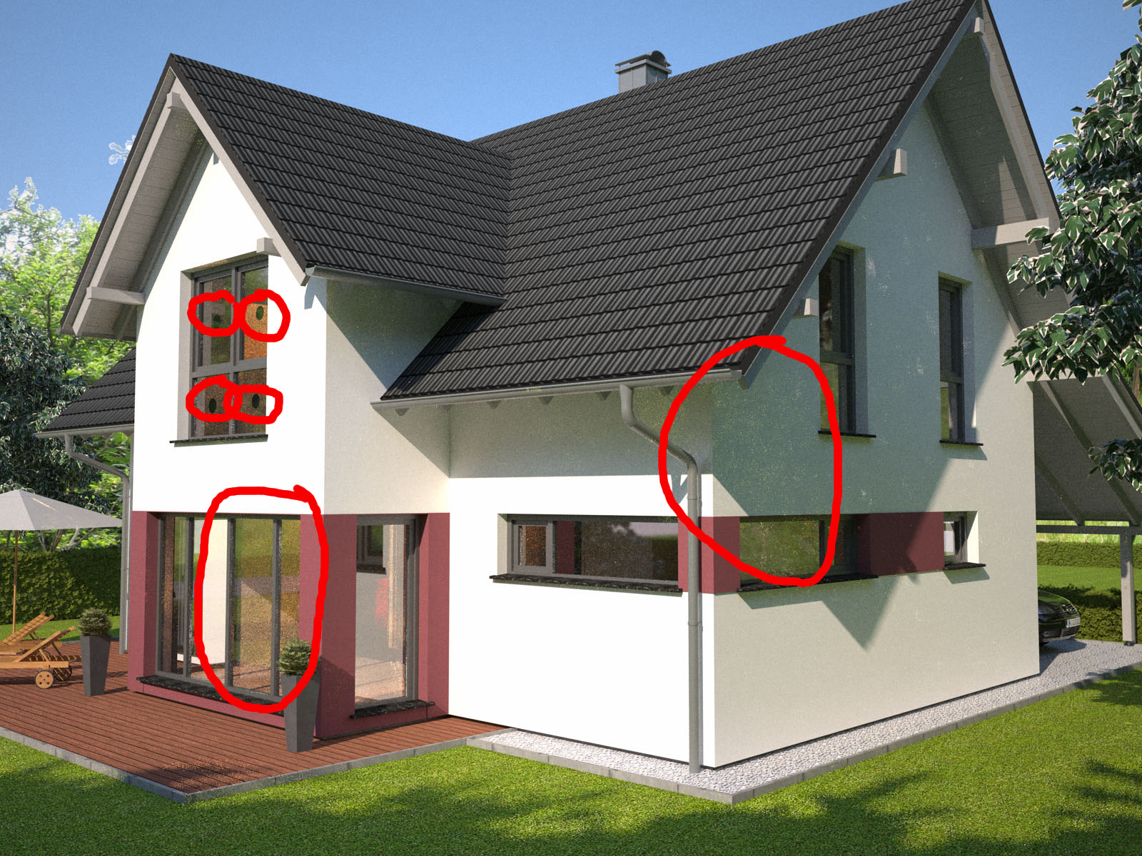

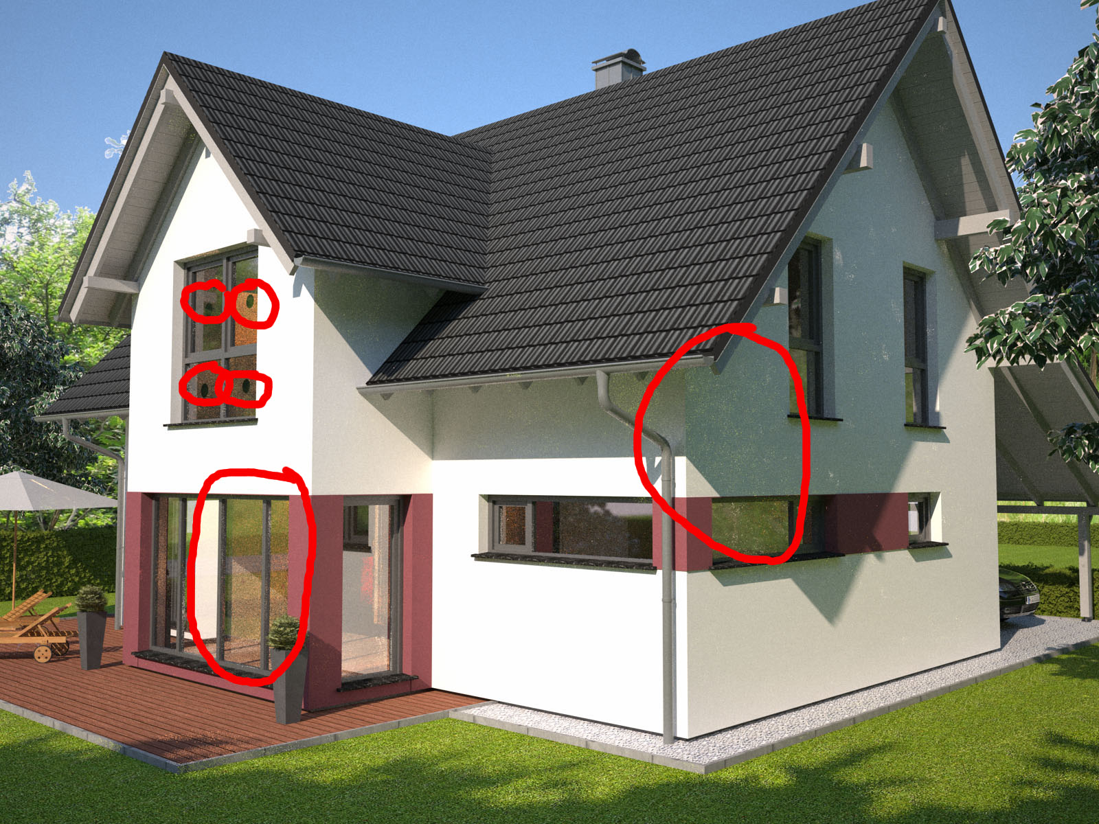

Hi Zom-B,
here is a picture sample from one of my collegs.
Look at my red marks. It looks exactely like a
picture with about 15 Minutes rendertime.
what can I say. We did everything as usual. Same Materials.
No Lightlayers, just the sun.
We render many pictures every week. We have Projekts here,
wich we rendered without any problems at all in C4d R12.
THE SAME projekt with the SAME MATERIALS and the SAME SUN
does not work anymore. Exactely since we use C4d R13.
And the black circles in the windowglas: We see them the first time;
never seen anything like that!!
Daniel
Hey Daniel,
change render-mode to PT+BiDir and enable glass acceleration,
this should boost your render quite a lot! MLT isn't best choice for exterior renderings!
Also check your leafe material for the trees and use a mask map or simply exchange texture to PNG with alpha channel (should work out of the box!)
