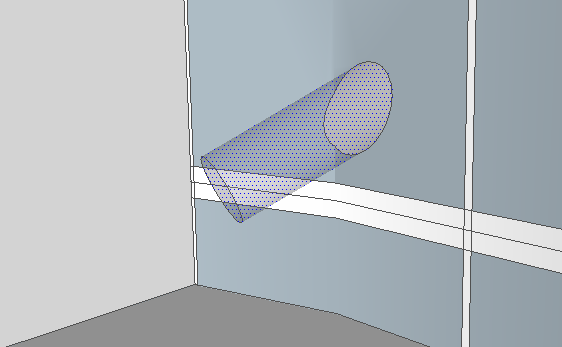

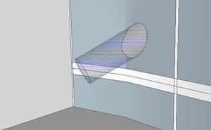

Basically im trying to get an effect similar to the way fiber optics work but with a much wider "wire" if you will. I hope the images below can describe it better for me! :oops:
Before render. The "pole" is going through the wall and im hoping for it to transfer the daylight form outside.
But the light doesnt seem to diffuse very strongly, and the glass is almost invisible.
Any help would be amazing!!
Thanks! :D

Hi rhibee
Are you using some scatering material ?
Using an ideal optic fiber in vacuum one wouldn't se light wiithin because photons would entirely be reflected to the other hand and run away unstopped. You need some scattering either within the tube or the room or both. Besides, you mat need a longer tube in order for TIR to take place efficiently (greater length/radius ratio).
See those two to get the idea:
http://www.indigorenderer.com/materials/materials/121
http://www.indigorenderer.com/materials/materials/125
You'll have to change the IOR for the conductor. In both cases you can set absorbtion to zero just to get the effect.

Re: Newbie ATTEMPTING total internal reflection
Post by fused » Tue May 24, 2011 10:50 pm
rhibee wrote:PS
The image above is using the setting "thin glass" for the glass tube. if I set it to anything such as specular with transparency its even WORSE....
the "thin glass" does not do TIR, you need to use a specular material with a medium.

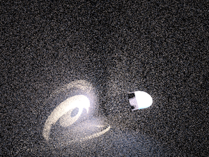

MLT doesnt seem to be a help though... just get this
Yuk!

Post by fused » Tue May 24, 2011 11:07 pm
I made a scene like yours and only Bidir seems to work best.
Here is my result (very quick render):
pretty cool effect!
What I can tell you from my experience with it:
- make sure the walls have a thickness, otherwise light will leak in.
- use a specular material with ior ~1.6, do not use absorption (leave default setting, which should be no absorption)
- use bidir (maybe with MLT)
And thats about it :)
