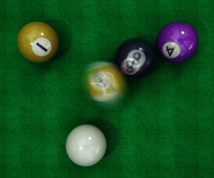

... so I am tired of fiddling with motion blur and materials to give the balls some depth and call this finished.
When I was looking for references I came across this:
http://www.fxguide.com/featured/1984_-_ ... ars_later/
That's such a nice idea, if you feel like just try to do your version of the shot and post it here. I didn't want to sent them my shot cause the render times don't quite compare...
Still not 100% sure about the ball material, please comment if you are a pro at playing pool, I was drunk the few times I gave it a shot :) and don't remember the material properties.
What bothers me still that faces of the ball meshes are showing due to SSS, the balls look perfectly smooth when they are phong, and using a little bit of SSS makes them look like the "solid"-setting in blender. What am I doing wrong? :(

Polinalkrimizei wrote:What bothers me still that faces of the ball meshes are showing due to SSS
I had a lot of that issue with bump on my 5d Mark II project, dunno if it's the same thing with SSS though.

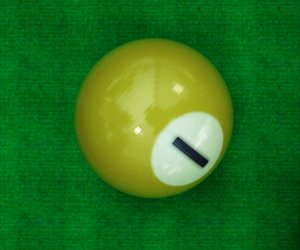

Post by Polinalkrimizei » Wed Feb 16, 2011 6:31 pm
The ball looks pretty pixelated to me, if I use plain phong it is perfectly smooth, with a tiny bit of SSS I get this. I'm almost sure it was discussed here before, is there a workaround or something I did wrong? Otherwise I will need to subdivide the faces until sub-pixel level, which is ok with a ball, but not so easy with more complex meshes.

Polinalkrimizei wrote:The ball looks pretty pixelated to me, if I use plain phong it is perfectly smooth, with a tiny bit of SSS I get this. I'm almost sure it was discussed here before, is there a workaround or something I did wrong? Otherwise I will need to subdivide the faces until sub-pixel level, which is ok with a ball, but not so easy with more complex meshes.
Normal smoothing!

As Soup said - Normal smoothing is name of the game. Check this under material or geometry properties. Those are not pixels. Those are polygons and smoothing is obviously turned off.
No offence but it is advisable to gather some basic knowledge about your 3D application. You don't have to read your manual from cover to cover, but the fact that you don't make difference between pixels and polygons, shows you have skipped some basics.

Thanks guys for your replies - of course it was just a normal smoothing issue. I was confused cause all the balls were "set smooth" in blender (as seen in the testrender at the simple renderings thread), but as soon as I added some SSS, normal smoothing was set to false for some reason.
