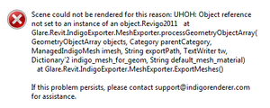

I am trying the new Beta 5 today. It worked on a simple test scene with a couple simple masses. However, on a real project file I'm working on with a number of more complex mass families, it did not work. I attached a screen cap of the error message.
Thank you.
