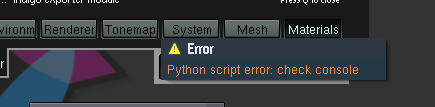

Hi,
I have the same problem in Blender. There I can't set a material as 'external'. And I coudn't find a way to import or link an igm/pigm-file.
When I try to use an external material I get the following error:
What does it mean?
And a question else about unwrapping: Do I have to unwrapp exactly to the material texture like in typical uv mapping procedure?
What does it mean?

Re: Applying materials
I have Blendigo 2.44. I tried to install release 2.61 but nothing changed.
I removed the blender folder completely but after reinstalling blender all settings and scripts were as before.
Where does Blender save settings and pythonscripts?
In Blendigo, of course, I can choose external materials. But inside Blender? Maybe I misunderstanded the previous postings (....you create a new material inside sketchup and you set it's "type" to external...). Did he mean skindigo?
You should post in the Blender forum, and in a new thread. It will get more attention that way
