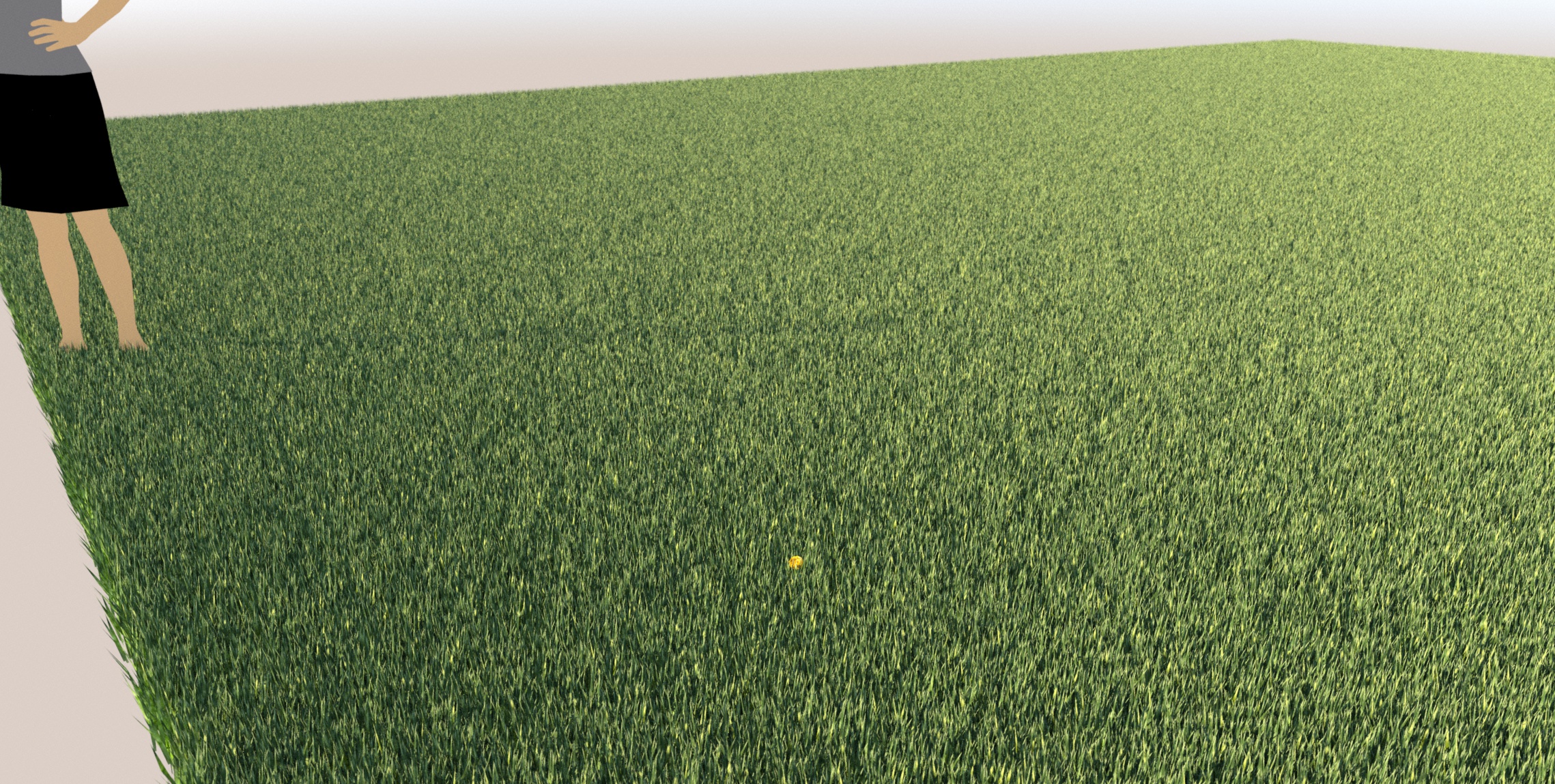

Skindigo on 1x 6950x, 1x3970x, 6x3930k, 2x4930k, 3x5930k
Re: SkIndigo 3.6.8.1
My first attempt is attached to this post - densities are about 2000 and 4000 for the 2 types of grass.
I've added a curved surface instead of a flat one, and added two more types of scattered object (total is now 4).
