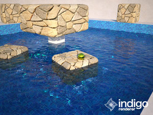

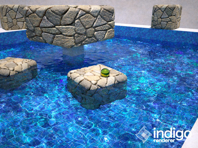

So I tried keeping all values between 80% of RGB max for white max, and 20% of RGB for black at the minimum. ie between RGB 51,51,51 and 204,204,204
I guess that means the same for any colour, have no single RGB colour channel outside of the 51-204 zone?
Rendered much better. 20% RGB black looks grey, but renders black. Indigo's MLT is still attracted to the white areas though.
So what I learned with Indigo's MLT, darker colours don't render caustics as quickly as brighter surfaces.
And with all things equal, the more complex the surface colour scheme is the slower it also renders. MLT also does not like irregular surfaces.
Here's another variable, the Sun position has a major influence on how quickly caustics appear!!
I set the sun relatively low, and put in typical pool complex tile pattern, which I know renders caustics slower than a pure white surface. Looks fine underwater
But above the surface, at 300+ samples, the pool surface and cube is just not lighting up all that well...
Now I set the sun to near Noon position, up high in the sky and suddenly all the caustics render really fast! Samples per second is also lower. At only 230+ samples it has way more caustics than the above lower Sun render.
So it seems Indigo has a hard time finding the sun to render the caustic when there are complex surfaces, irregular water surface bending the light rays and the sun in a low position.
Keeping the Sun around the 10 to 2 o'clock position can make you a happier person :)
Off course to would be nice to use a lower Sun position, hopefully Glare will one day have a solution.

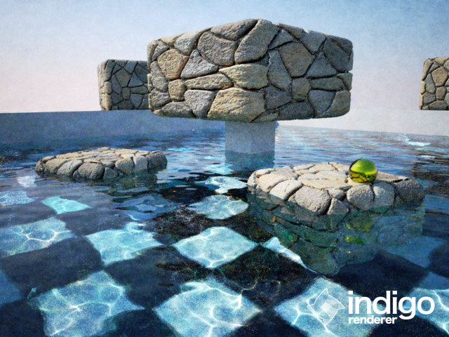

I tried Bidirectional Path tracing again while taking a nap. Rendered up to 1600+ samples, and it was a big fail :)
Everything above the water looks photoreal, but the underwater rendering looks out of place, no light transmission :P
1600+ samples
Curently doing a comparison between MLT and Bidirectional MLT, and there seems to be quite a big brightness difference between the 2 modes, and between path tracing as well

What a firefly party. 8)

They would probably turn into caustics, given enough rendering time, especially under GPU acceleration :)

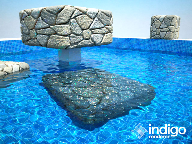

had some strange results rendering the scene with MLT vs Bidirectional MLT.
BMLT is more effecient on paper, but it runs at half the speed of basic MLT. So while it is more effecient and can resolve more details better, it's not 200% more effecient, so for the same render time, it's still more noisey than basic MLT, but it does render some areas better, and doesn't have all the weird multi-coloured splotchy artifacts that basic MLT throws around rather randomly. But the next build of Indigo is supposed to get rid of all these MLT artifacts, so that might tilt the balanced towards basic MLT for most scenes...
Interestingly enough, there are speckles of caustics on the underwater object in both.

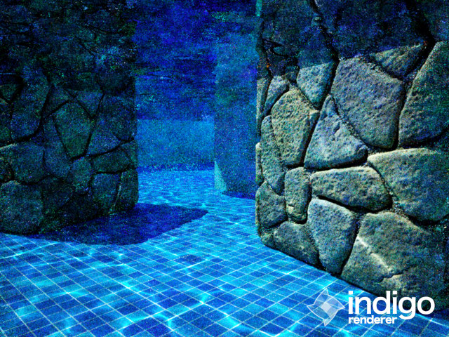

Wanted to see if the render above with Bidirectional path tracing would improve with more time, nope not too much at 5000+ samples :twisted:

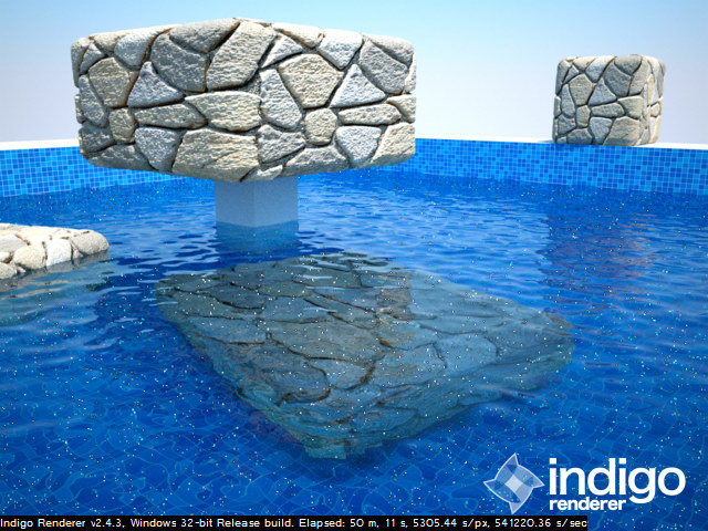

Anyway Indigo does run faster in Windows 7 64 bit, I get 560k s/s with the Caterpilla test scene, and 538k in XP, 32 bit.
same scene rendered with basic MLT at something like 9100+ spp. I was getting 650+k s/s. Some speckles of caustics on the underwater object. You can see some areas like the pillar bit, just aren't explored all that well even at such a high SPP
And plenty of splatty artifacts
MLT settings of Large Mutation Probability of 0.33 and Max change 0.004
MLT

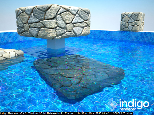

With Bidirectional MLT, with SSS and CauchyB disperion in the water. 6783 SPP. S/S is half the rate of basic MLT, so I don't think it's well optimised. Bidirectional Path tracing isn't half the speed of basic Path tracing...
More effecient off course, but that underwater object will take ages to light up! The SSS and dispersion cleared up fairly quickly, much to my surprise :)
MLT settings of Large Mutation Probability of 0.4 and Max change 0.008
BiD MLT

BTW as you can see from the last 2 renders, the MLT Max Change does have a big effect on hard to reach caustic detail. The default vale of 0.01-0.008 is good for quick previews, as they cover the whole scene fairly quickly, but lower settings down to 0.003-0.002 get into the finer details better, but stay splotchy/smudgey for a lot longer, and rely more on the large mutations to smooth the scene out
