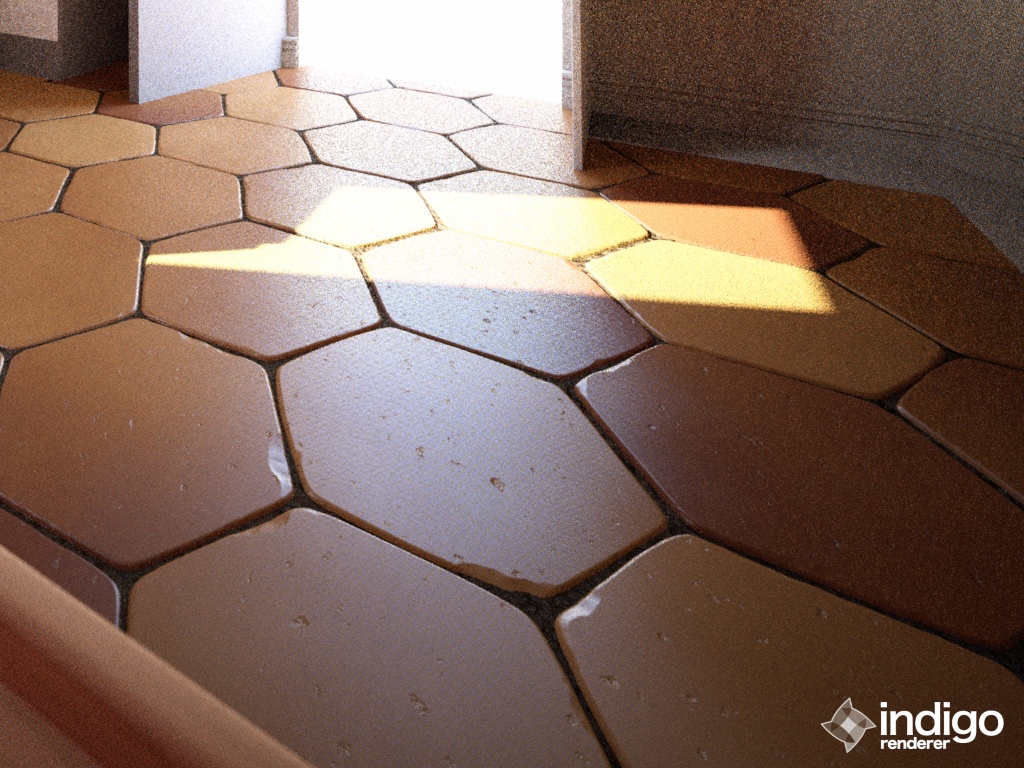

Re: Full-procedural ceramic tiles material
Post by CTZn » Tue Feb 23, 2010 9:29 am
I'm wondering if my last post was pruned or perhaps I did just not send it...
Here's the shader nearly in situation... I'm not sure I used the DB version because it looks different. In another of my tests the displacement was obvious (tiles use displacement instead of bump mapping... I think), maybe I overwrote that.
deleted image, see below
oh I'm abusing lens shift, the film center is off the image so there's a lot of distortion.
Post by CTZn » Tue Feb 23, 2010 10:22 pm
Yes, that's how I named the file, a draft ! My mistake, I was more involved in smooting the workflow with IGMs than actually looking into the shader. Same mesh settings than above, only CRF/whitepoint changed.
1563474 triangles for the floor.
I can nothing but insist on that not using curvature threshold bypasses the issue. 9 times on 10 I don't, precisely because I'm not happy with its results :) I'll now compare the triangles counts and results with curvature threshold and see what gives.
Should I add: awesome shader !? If you want me to fall in love now you must do a worley tiling :lol: Awesome.
edit: adding a curvature threshold of 0.1° (0.001745329026 radians) has no impact, it's too low. No change with 1° either, I'll try higher values...
