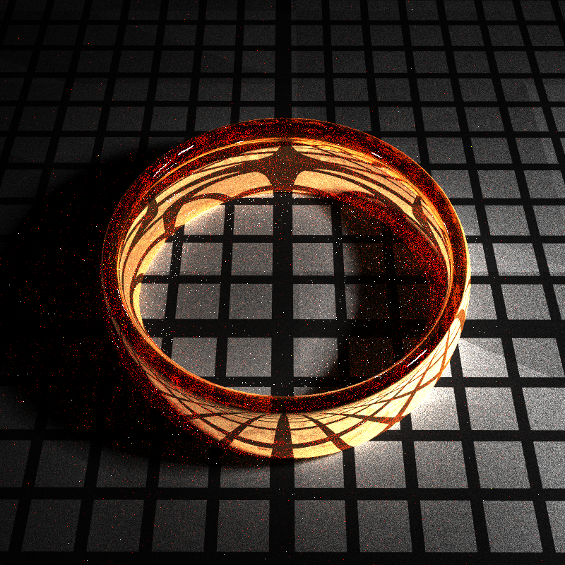

i got MLT working! precedence doesn't quite work yet and i'd be carefull when putting two refractive materials within each other, but other than that, it seems to work. rays are still re-shot in glossy materials. i'm currently working on another method that doesn't even allow rays to be shot below the normal. i also took out the code that decides the importance of the threads, i'm not sure how well threads would work with the mlt anyway. i havent yet got the resume to work with MLT. there is also a new tag in the scene file that specifies use of MLT: sample metro
here is a new image of some caustics, note that the caustics might not be bright enough because the render of this picture lacked compensation for the probability that the ray might end without hitting the light.
TLRcam.zip
(150.41 KiB) Downloaded 194 times
a shiny monkey is a happy monkey
Post by OnoSendai » Fri Oct 05, 2007 2:40 am
Congratz!
