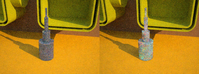

limiting ray bounces down to 3-5 will allow you to preview SSS and materials a lot faster!!!!!!!!
SSS material is set to Chocolate Milk settings
I actually used the x10 values from the PDF - so I guess they are correct after all :o
The model has correct size values. 20cm diameter for the bottom segment, 10cm for the 2nd, 5cm and then and 2.5 cm for the top one
left pic - ray bounces set to 5, on the right set to 10000, but even 100 bounces looks the same...
Both rendered to 50 samples, about 5 mins here on MLT, Max "large_mutation_prob" "0.4" "max_change" "0.03"
I know which looks closer to chocolate mlik already :D
BTW max_change value of 0.03 is far superior to the default value of 0.01 for getting SSS materials up fast rather than the smudgey splotch you normally get earlier on!
