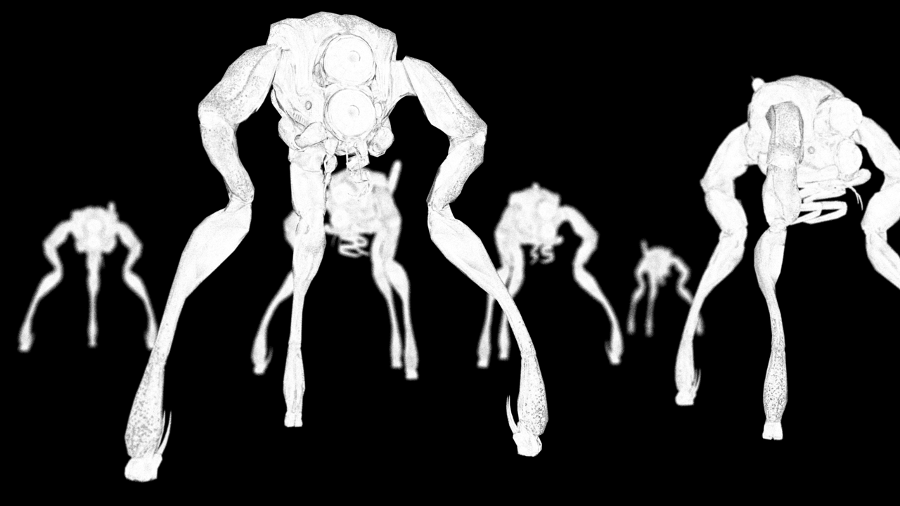

Post by Zom-B » Tue Jan 29, 2008 9:08 am
Hey Ono...
It seems there is a interesting Issue using Render Alpha with meshes having a Textures Color, Bump Map and exponent Map!
The attached Image is rendered with color+bump+exponent Map...
Is this a feature or a Bug ? :lol:
Something you can fix, or have the exporter writers disable texture export for Alpha render?!
**EDIT**
It seems this issue is also related to Mesh geometry, because even if I have no Textures on the mesh, there are still geometry boarders visible!
BTW: The Model is the HL2 EP2 Hunter
