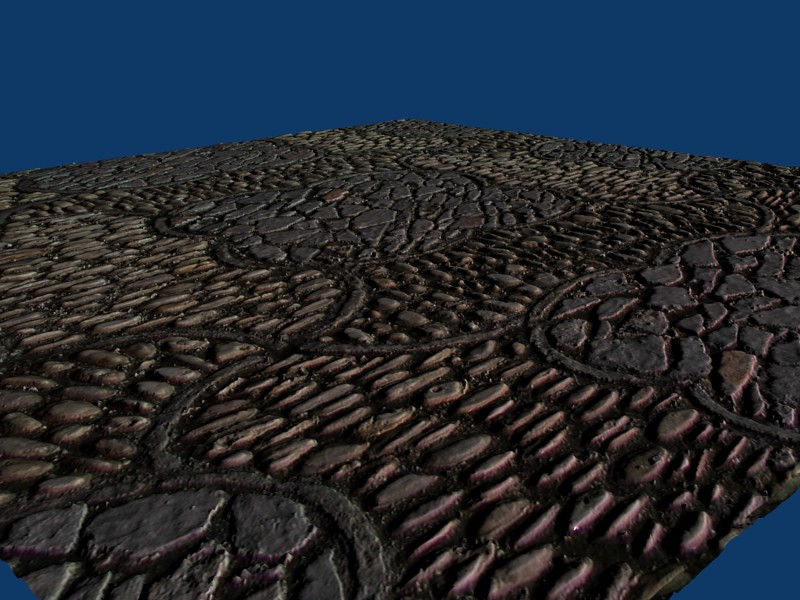

OK. If I understand well, displacement in Blender as a material attribute doesn't actually create new geometry, but merely moves existing vertices. It is therefore exactly the same thing as using the Displacement modifier. Which has the advantage of giving you a result in the viewport.
Here's what I obtain using the displacement modifier. I had to subdivide this plane quite a few times (it is 65,000 polys). I use my heightmap also in the "normal" channel.

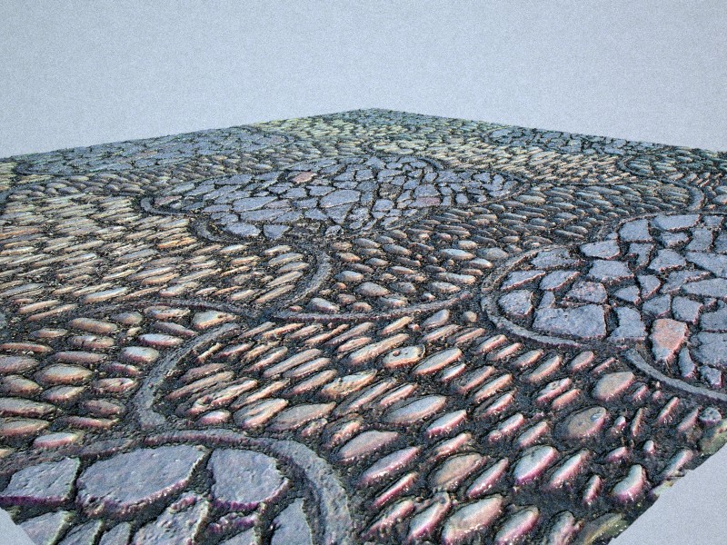

I've got an Indigo version cooking.
Post by BbB » Mon Nov 26, 2007 2:09 am
Indigo version

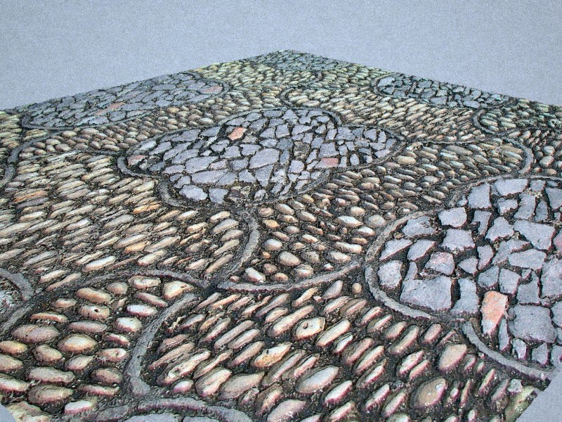

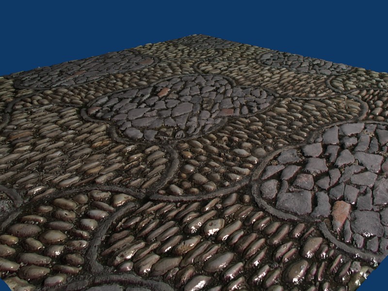

Subdivided once more. It's beginning to look nice, but at 260,000 polys, it would, wouldn't it... :wink:
EDIT: Not enough RAM to send this one into indigo...

Post by BbB » Mon Nov 26, 2007 2:29 am
I guess so! Actually, I managed to scrape just enough RAM to send this one into Indigo after all. Will update with a dirty render soon.

Post by BbB » Mon Nov 26, 2007 2:39 am
There you go. Apologies for the texture's bad quality.
At this level of polys, though, this is not going to be much use.
The search for the perfect displacement method continues...........

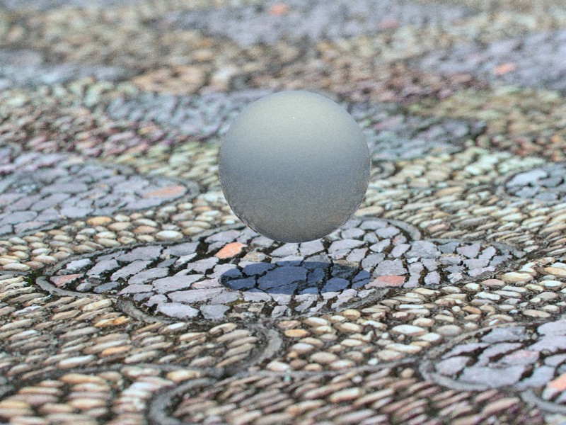

Post by BbB » Mon Nov 26, 2007 5:10 am
Instanced cobbles
