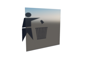

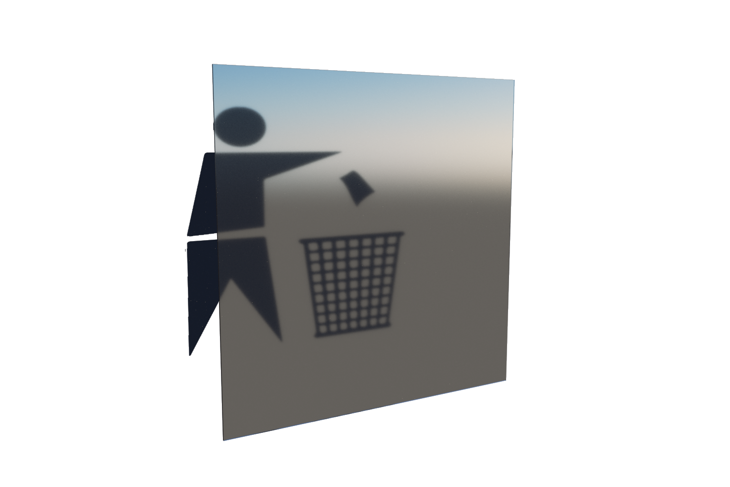

I have also discovered one problem.
Render glass material and use alpha background.
1. Glass as specular is ok. Background behind glass is transparent
2. Glass as glossy is not ok. Background behind glass is full visible
Related problem is - If I click on glass material and change from glossy to specular (or conversely) Indigo crash.
GlassScene.pigs
(118.61 KiB) Downloaded 1306 times

Hey pavoda,
Interesting about this Glossy T. alpha issue, I'll create a ticket in the Bugtracker about it, thanks for reporting!
Regarding the crash I can not reproduce this on my GPU and CPU...
Is this maybe on GPU only? Do you use the latest drivers?
Does Indigo create a minidump on next start? can you upload it?

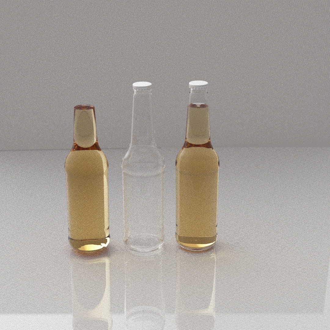

Hey guys, not sure if this was reported before - there are subtle differences on how intersecting specular mats are handled in GPU and CPU mode.
The liquid and the glass are just specular mats without sss, WITH sss on it appears to be the same "problem". The liquid has a lower precedence than the glass. And may not be modeled perfectly.
On a side note: This improved much since 4.0.50, where the full bottle was rendered grey - I just updated and was actually more pleased with the results than before!
Last edited by Polinalkrimizei on Tue Aug 22, 2017 10:08 am, edited 1 time in total.
Re: Indigo Renderer 4.0.55 Beta Release
Post by Oscar J » Tue Aug 22, 2017 10:00 am
Looks like you just need to raise ray depth (under GPU settings). :)
Polinalkrimizei
Posts: 649
Post by Polinalkrimizei » Tue Aug 22, 2017 10:09 am
Oh awesome!!
Will try that, thanks :-)
Polinalkrimizei
Posts: 649
Post by Polinalkrimizei » Tue Aug 22, 2017 10:12 am
Seems to work :-)
