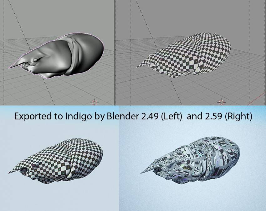

Well I seem to have hit another potential bug with Blender 2.59. UV mapping seems really screwed up. Same objects works fine in other renderers incl Blender 2.4x but the UV mapping renders out wierd on my 2.59. Anyone else having these issues?
Doug

by dougal2 » Fri Aug 19, 2011 8:05 am
Doug Armand wrote:Well I seem to have hit another potential bug with Blender 2.59. UV mapping seems really screwed up. Same objects works fine in other renderers incl Blender 2.4x but the UV mapping renders out wierd on my 2.59. Anyone else having these issues?
If the model contains triangle faces, then yeah, I know about it and it's related to the other hard crash.
The fixed exporter is ready to go, I'm just waiting for the nod from Glare.

by Doug Armand » Fri Aug 19, 2011 8:31 am
I know this isn't a Blendigo problem but am posting this here in this forum because
a: it might save anyone from pulling there hair like me trying to work it out and
b: the clever bods here may know what is going on and can offer a fix
OK here is how the UV problem is manifesting itself for me:
Exact same Blender file was used for both renders.
Doug
Doug Armand
Polinalkrimizei
- Posts: 649
Post
by Polinalkrimizei » Fri Aug 19, 2011 10:08 am
Hey Doug, I am having the same problem, and it seems to be related with the "smooth" option in blender. Objects that are set smooth are completely messing up the uv layout, but if you set them flat it works. Can you confirm that?

Polinalkrimizei wrote:Hey Doug, I am having the same problem, and it seems to be related with the "smooth" option in blender. Objects that are set smooth are completely messing up the uv layout, but if you set them flat it works. Can you confirm that?
Yep I can confirm that. Using flat shading renders UV's as expected. Hmmm back to 2.4 till its fixed I guess?
