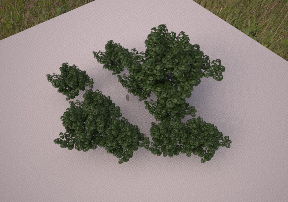

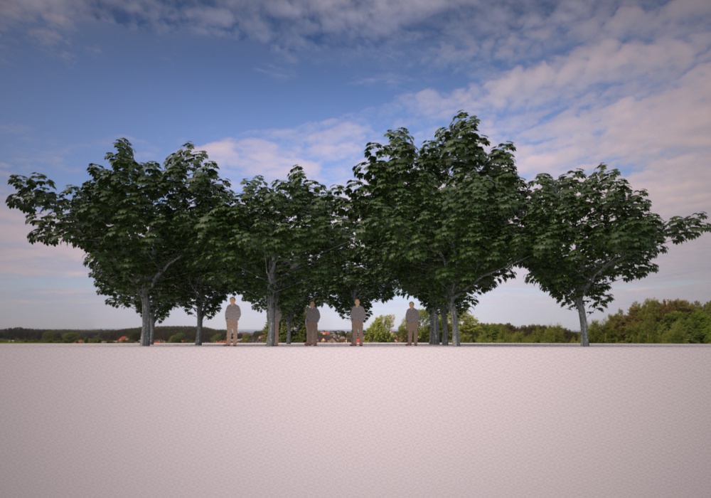

Definitely a +1 for dummy components.

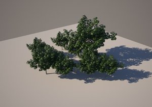

Here are some examples using a high poly tree, even one of these trees in a Sketchup scene destroys performance to the point where I can't even work. Using dummies I can still rotate and pan etc happily with multiple copies and let my Derricks have a lovely bit of shade :)

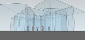

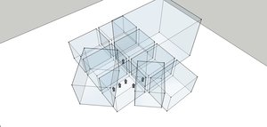

I use dummies for high poly cars and trees. You can make them larger of smaller and rotate etc just by rotating and scaling the dummy component. I make my dummies see through so I can still place trees etc and see whats behind and under.
You still get the shadows of the tree component too.

Essentially a dummy is just a fake version of a component you have in a scene. So for example that hi poly tree I have is called 'Mapletree'. If I make a new component, say a simple box a similar size to the tree and call it 'Mapletree_dummy' then it will render with the properties of the 'Mapletree' but the scene doesn't need the actual 'Mapletree' component, so it can be deleted (leave it in the components list though, don't purge it completely) resulting in allowing me to scatter loads of 'Mapletree' dummies around without actually having them in my scene destroying my PC. Dead easy.
To make a component select whatever you want to be a component, press 'G' in sketchup and give it a name - voila, component created.
So in steps:
1) Find your fancy item, tree, car whatever. Import it from an .obj file or .3ds file, download from the warehouse - whatever you like.
2) Plonk it in your scene in sketchup.
3) Make a note of the component name. If its not already a component, make it one (Select and then press G as above) and give it a name. Lets call ours 'TREE'
3) Make a box or whatever you like to act as a dummy.
4) Select your dummy and make it a component, and give it the name 'TREE_dummy'
5) Delete the high poly tree component.
6) Job done. Render. The dummy will render as if you had the actual hi poly tree there.
